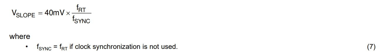

Vslope is calculated by equation(7).
What is this "40mV"?
Is this a specific value of LM5155?

Hi Huramochi,
Thank you for reaching out. 40mV is the amplitude of the internal slope compensation without external clock sync. Yes it is a specific value of the LM5155. If you sync to a faster frequency, the amplitude of slope compensation will reduce by the factor of fRT/fSYNC.
