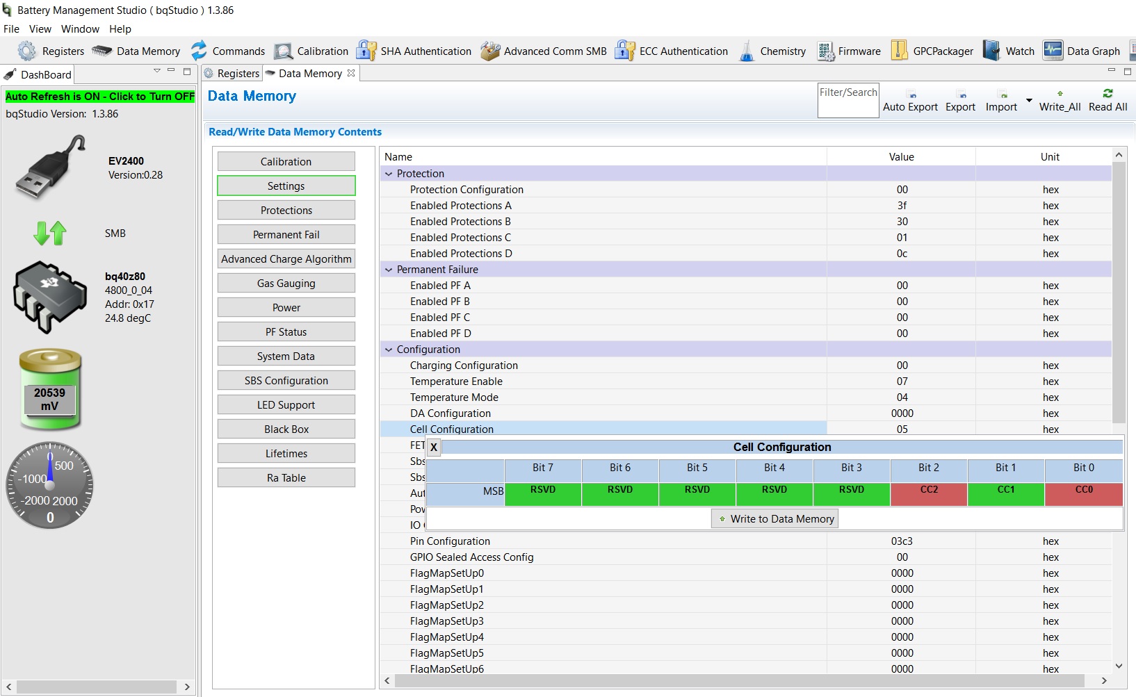

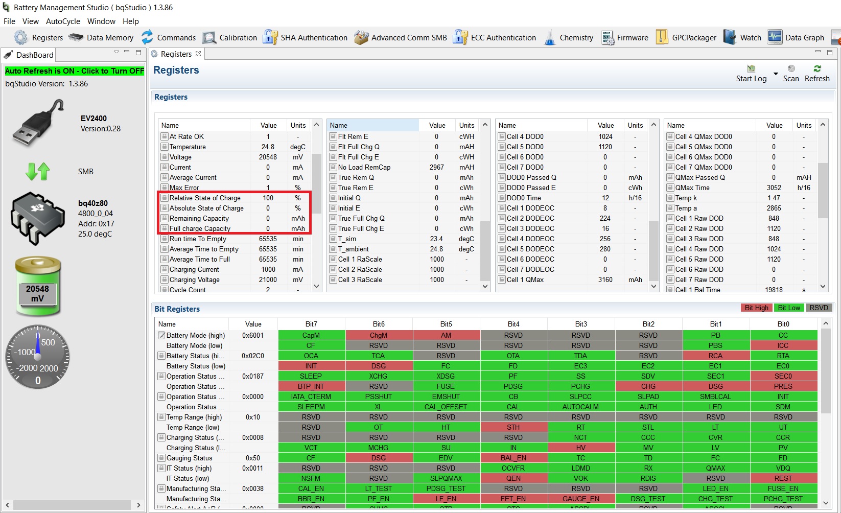

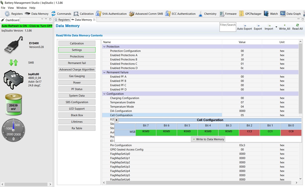

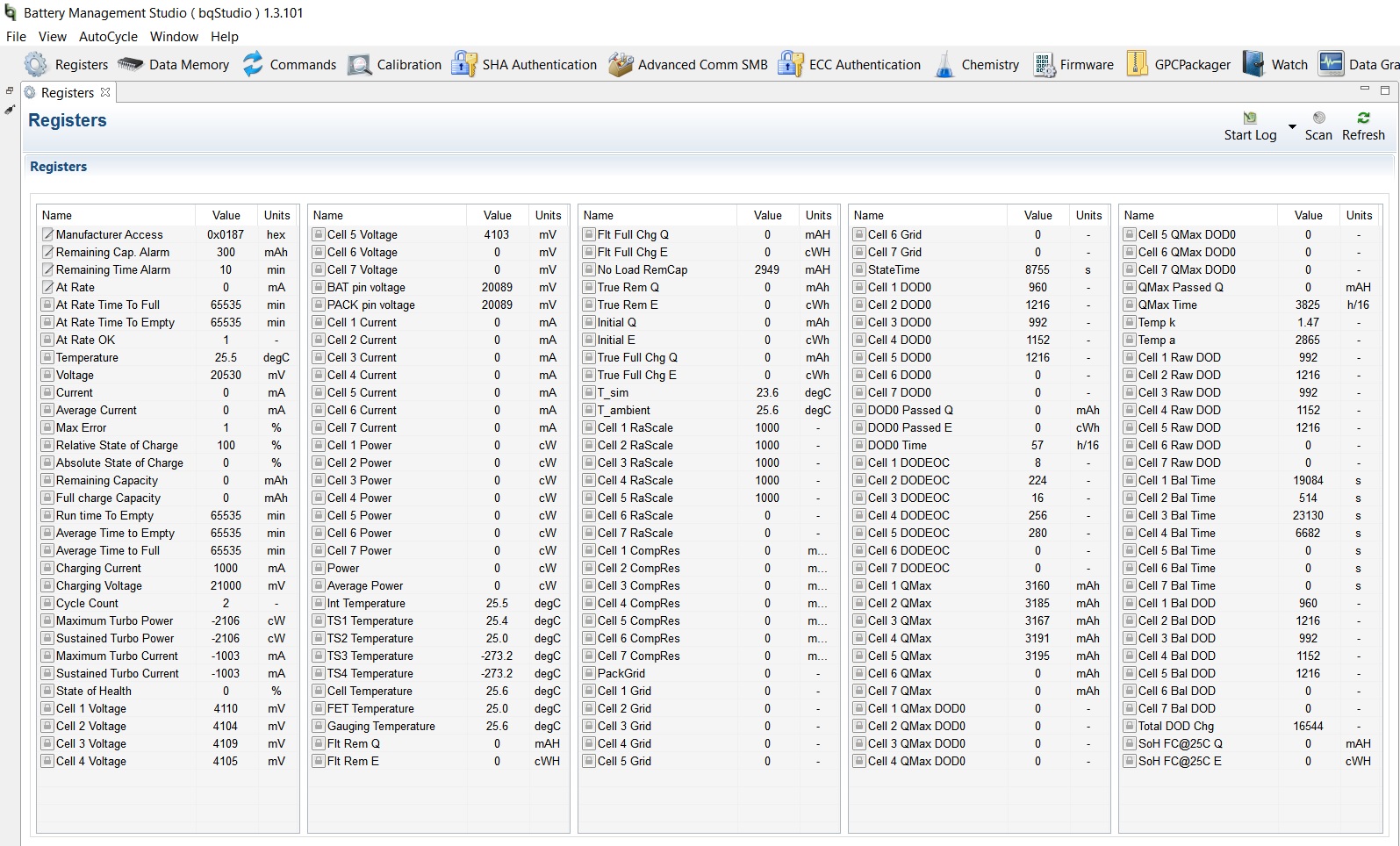

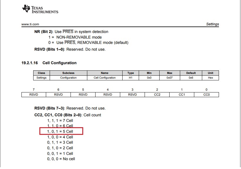

Hi
We are faced with the problem of determining the Full Charge Capacity in the bq40z80 chip. When setting the chip, Remaning Capasity and FCC for 5 cells are displayed incorrectly, however, when setting 6 cells, Remaning Capasity and FCC are no longer equal to zero and they are being calculated. Due to the problem of calculating these parameters, State of Charge is always 100%, which leads to incorrect operation of the Terminate Charge parameter.

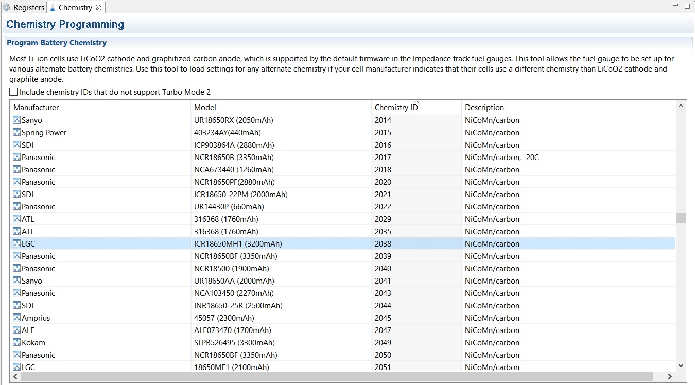

We did a training process and got updated Qmax and Ra_Table, but the capacity is still not displayed correctly. Please help me solve this problem.5s_FCC-zero.rar
