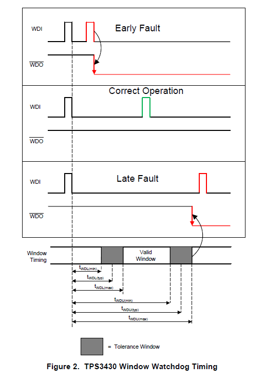

What exactly happens if the reset pulse occurs between 1.0s-1.5s and 1.7s - 2.25s?

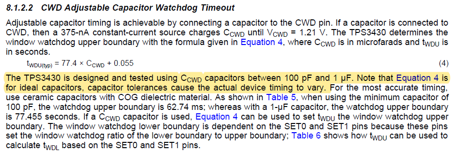

    Just to be clear, you are looking for a timeout range from 1s to 2.25s, correct?  If you set both SET0 and SET1 to "High", you will get a window time-out time between 800ms to 1600ms.  Is the 1600ms you are referring to the typical watchdog timeout period of 1.6s?
    The min and max range is specified because the calculations are based on ideal capacitors.  See below:
    The picture below details what happens if a WDI pulse occurs outside the watchdog window:

  • Hi Frank,
    There are min and max limits because of tolerances when manufacturing silicon, over temperature, VDD input range, and etc.
    There might be some confusion on your end regarding the limits.  Typically, you will get 200ms of delay but at one extreme end of the temp or voltage range and/or process variation, the output delay may not be at a typical 200ms.  With the min and max spec range, TI guarantees that the 3430 will have an output delay time between 170ms - 230ms over temp, VDD, and process.
    I hope this clarifies any confusion that you may have on the reset delay time spec.
