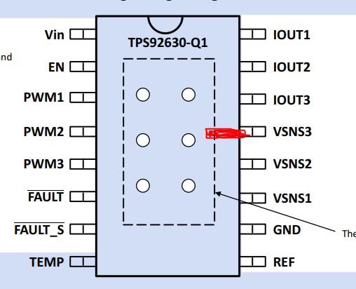

My customer doesn't use  the current sense for all channels. The datasheet says VSNS1,2,3 should connects to IOUT1,2,3 respectively in this case. Is it okay to tie VSNS1,2,3 together to IOUT2? In customer application, IOUT1 and IOUT2 are active channels and IOUT3 is not used.

    Thanks. However, my customer can't tie each VSNS pins to IOUT1,2,3 individually because of a PCB area restriction.
    So, could you check if VSNS1,2,3 can be connected together to IOUT2? (Again, customer doesn't use the short detection.)
    If this connection is not acceptable, they can't use TPS92630-Q1.
    Also , could I add one more question?
    As I mentioned, customer doesn't use IOUT3. Datasheet says that PWM3 pin need to connect to GND when IOUT3 is not used.
    It is difficult for customer to tie PWM3 pin to GND because of limited PCB area. So, they wants to leave PWM3 floating.
    In the case that PWM3 is floating, how does IOUT3 work? If you don't recommend PWM3 is floating, could you teach me the reason?

    For TPS92630-Q1 there is a thermal pad that help to dissipate thermal,  and the thermal pad connect to GND. So customer just need to connect the VSNS3 to thermal pad on PCB layout to realize connecting to GND. I don't find any difficult.
