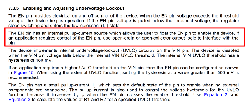

I would like to ask about the EN pin of TPS54335.
If you check the data sheet, you will find the following red frame for the EN pin.
I would like to ask two questions about the contents.
1. Our customer is trying to control the EN pin directly using the 3.3V IO of the CPU. Is this method okay?
2. The EN pin has a pull-up-current source internally, but at what voltage should this be considered to be pulled up?
(Since the device is enabled while EN is floating, it is considered to be pulled up at a voltage above the Enable threshold (1.28V or higher).)
