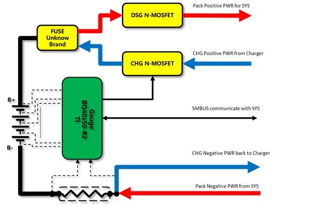

Can we use the BQ40z50-R2 for separated CHG and DSG MOSFET application?
Can we refer the SLUA952 or SLVA729A to do?
Please provide the recommendations for us.

Hello Statham,
I'm not sure what you mean for separated, one of the documents refers to parallel FETs and the other is using 2 paths, one for CHG and one for DSG.
You should be able to use these documents for references to accomplish what you need.

Hi Keller:
I search the older information from E2E.
That AE Steven told this action was not recommend.
Do you know the reason?

Hi Brylski:
If we separate the MOSFET can you let us know which parameters we should be setup?
Please help to provide your recommendations for us.
Thanks a lot.
Hello Statham,
Steven is correct, you would need to have more custom control on the MCU side and it can be more complex. With FET_EN = 0 the FET_TOGGLE commands can be used but then all firmware based protections would no longer be used.
We do have the PARALLEL_FETS that may be helpful to look into for your application.
