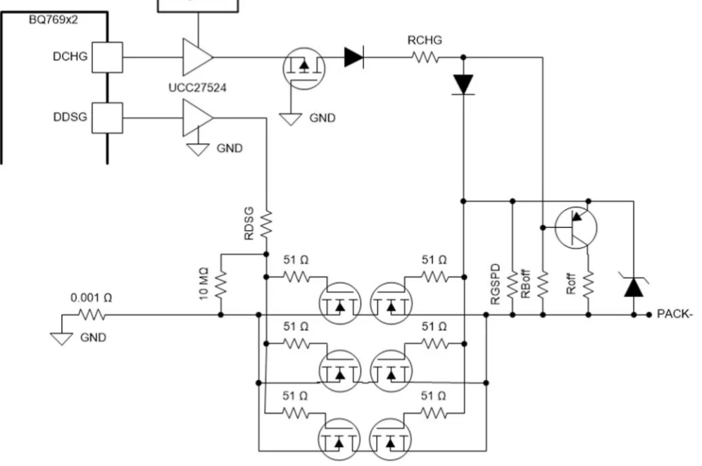

I am following below recommendation for low-side FET Drive:
And I have following doubts:
1. Is it okay to use a PNP BJT like BC856A-T?
As its had Emitter Base Voltage of 5V, but drivers are providing 12V for FET drive.
2. What should be specs of zener diode connected at output end, in terms of reverse breakdown voltage?
3. What should be considerations for choosing P-ch FET connected at DCHG Driver output?
Anurag
BC856A-T
  • Hi Anurag,
    1. The proposed transistor should be fine.  VEBO is 5 V maximum, but there is a diode between the emitter and base which will limit the voltage to its Vf when the charge FETs are on.
    2. The zener diode on the right side protects the charge FET gates.  If you are driving the FETs with a 12V supply there are 2 diode drops to the gate, so you may have about 10.5 or 11V on the gate, you would not want the zener conducting at this level.  The power FET likely has a VGS maximum of 20V although there are parts with different limits, you want the zener diode conducting (limiting) before this voltage. So typically a 15 to 18V zener would be appropriate.  Consider tolerances and your specific component limits to select components which fit your design.
    3. This will depend somewhat on your design requirements or standards.  In normal operation a cell might be used over a 1.5V range, so a 16 cell battery voltage might be 24V below the charger voltage, or PACK- would be -24V from "GND" in the schematic if the device has the charge FET off.  If your design standards recommend a 2x margin you might want a 50V FET.  That is for a normal condition.  If your battery has some fault and completely discharges to approximately 0V, you would want the P-channel FET to withstand the full charger voltage because you would not want to charge those depleted cells. Vgsth level may not be of great concern, it should be well below your normal driver output so that the FET is on.  Current capability is typically low, RCHG will limit the peak current but this will drop off quickly as the power FETs turn on and the PACK- voltage is pulled up to the BAT- voltage. Consider your situation and select appropriate components for your design.

    In  schematic, we have two different grounds as PGND(PACK GND) and VSS.
    Should I connect above GND pins PGND??
    Anurag
  • Hi Anurag,
    The BQ76952 was designed to connect VSS at battery- near the sense resistor.  High discharge currents will raise the voltage of SRP, SRN and positive has more range. Your PGND will move some with respect to VSS.  In the picture above the sense resistor GND would be battery- and VSS. For the driver GND and Pch gate I would suggest the VSS GND.  Connecting right of the sense resistor may work also.  PACK- would move too much.
