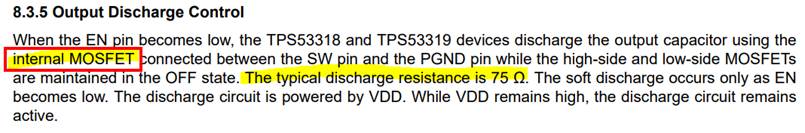

Hello team,
Customer is using TPS53319 and wondering if they need some kind of additional external load of 75 Ohm to make this function work or is it internal. I think the wording in the datasheet can be confusing and upon checking the block diagram, I do not see any discharge switch visible there, so wanted to confirm with the team. I see discharge FET shown on the TPS53317 for example, so I'd think it would be a similar case for 319, but would be good to confirm. Thanks!
