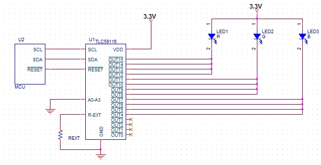

     Excuse me, the maximum output of each channel of TLD59116 is 120mA. If the circuit diagram is as follows, can each LED get a current of 120mA*4=480mA?

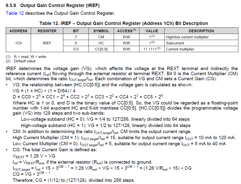

     How to set REXT if each channel wants to get 120mA? Is it directly grounded?
     Register IREF Bit7 needs to be set to 1 (CM=1)?
    Thank you.
