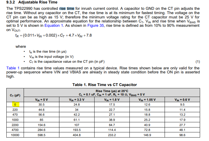

Dear sir
1.Conditions of use are
VIN=1.05V
VOUT=1.05V
VBIAS=5V
IOUT=0.6A max
Input capacitance=10u
Output capacitor=1u
Equipment requirements VOUT rise time+ON delay time should be within 65us
Does the design of ct=0uf cause problems?

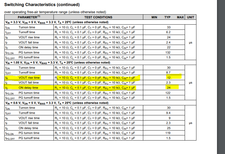

Hi Aaron,
it is ok to float CT, this will just result in teh minimum possible rise time.
Please see section 9.3.2 for data on rise time with 0 cap on CT pin. For 1.05V , you should expect ~12us rise time, nominal.
Please let me know if any additional questions. If this answers your questions, please help me with
ON Delay time includes for 1.05V 24us typ which meets your spec. You can even add capacitance to CT pin and it will meet your spec.
I've attached excerpts from TPS22990 d/s below.
If this answers your question, could you let me know by pressing the green button?
