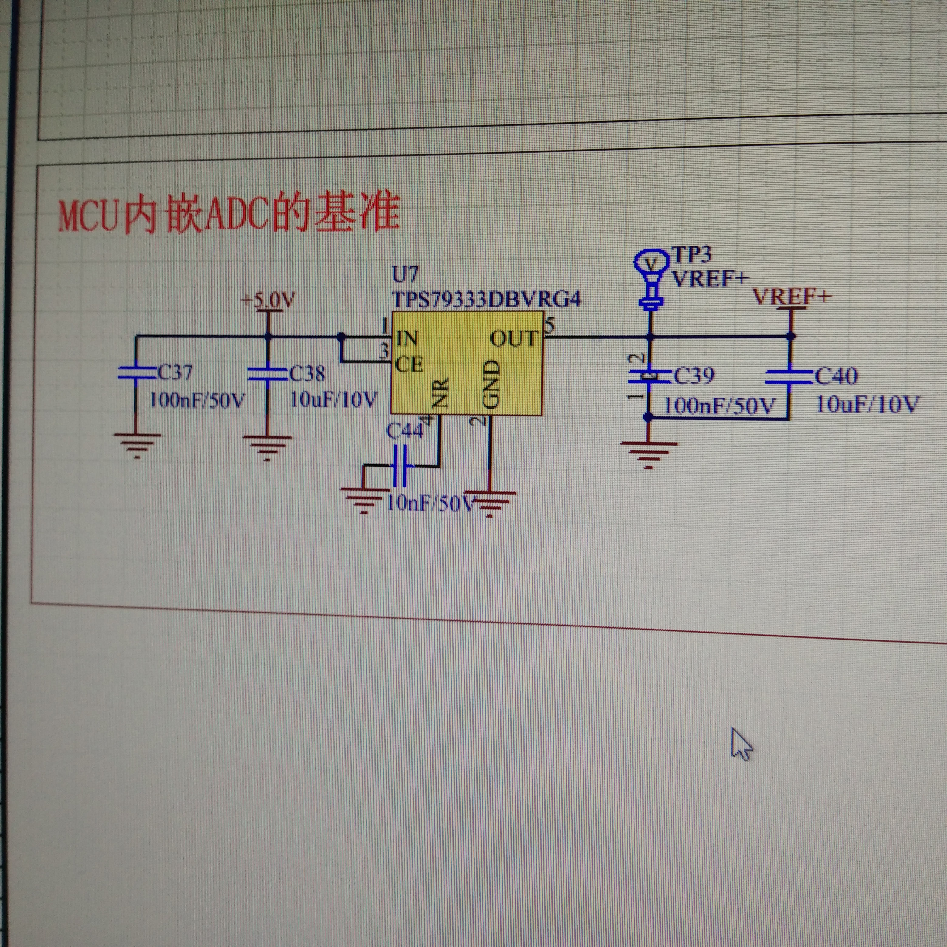

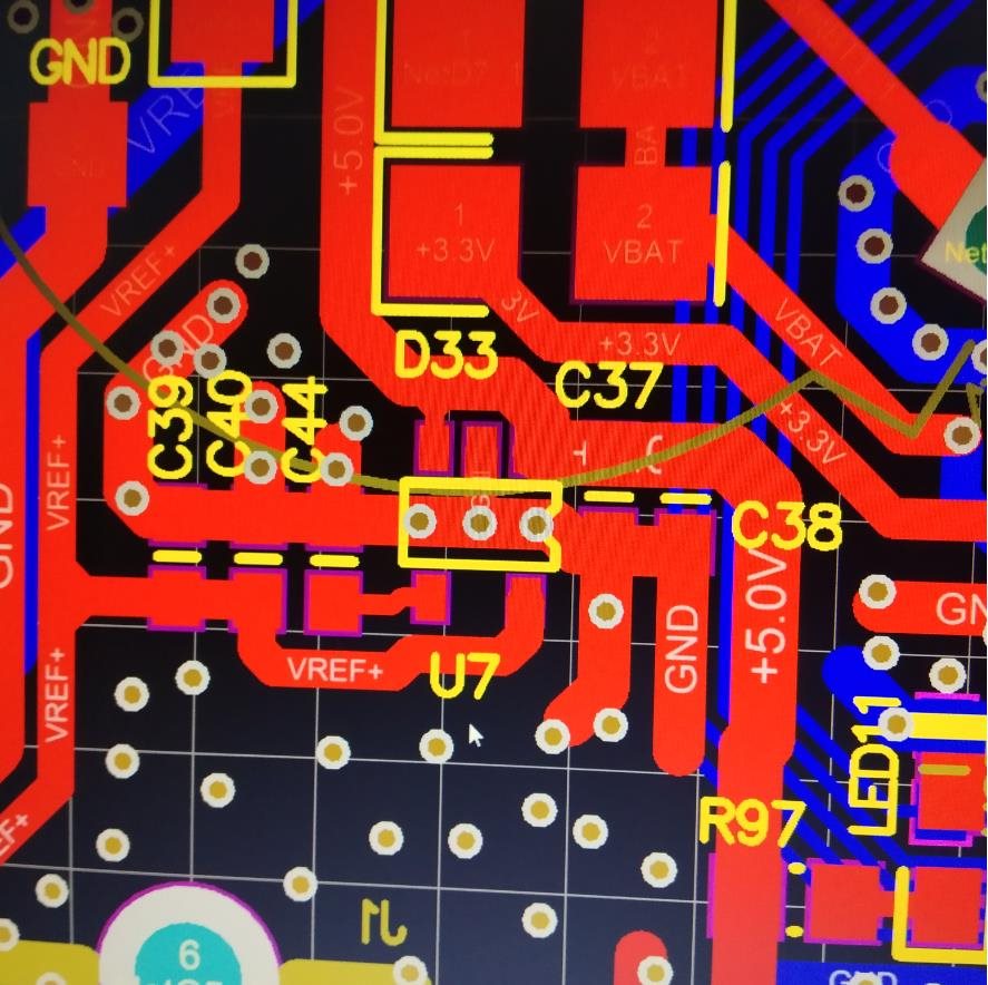

Recently, there are about 8pcs control boards with abnormal Vout output. We tested all the components of the control board, and finally located TPS79333DBVR with abnormal output, Vout=0. After doing a crossover test, it is normal to replace it with a new TPS79333DBVR circuit. Can you help us find out where there are design problems with our SCH and PCB? Or what do we need to pay attention to in design
Test data:
Vin=5V。
Vout= 0V,
VNR= 1V,
impedance TPS79333-OK TPS79333-NG
Vin->GND 1.4MΩ
GND->Vin (1.2-1.6)MΩ 1.2MΩ
Vout-GND 113.1KΩ 118.8kΩ
GND->Vout 113.1KΩ 118.8kΩ

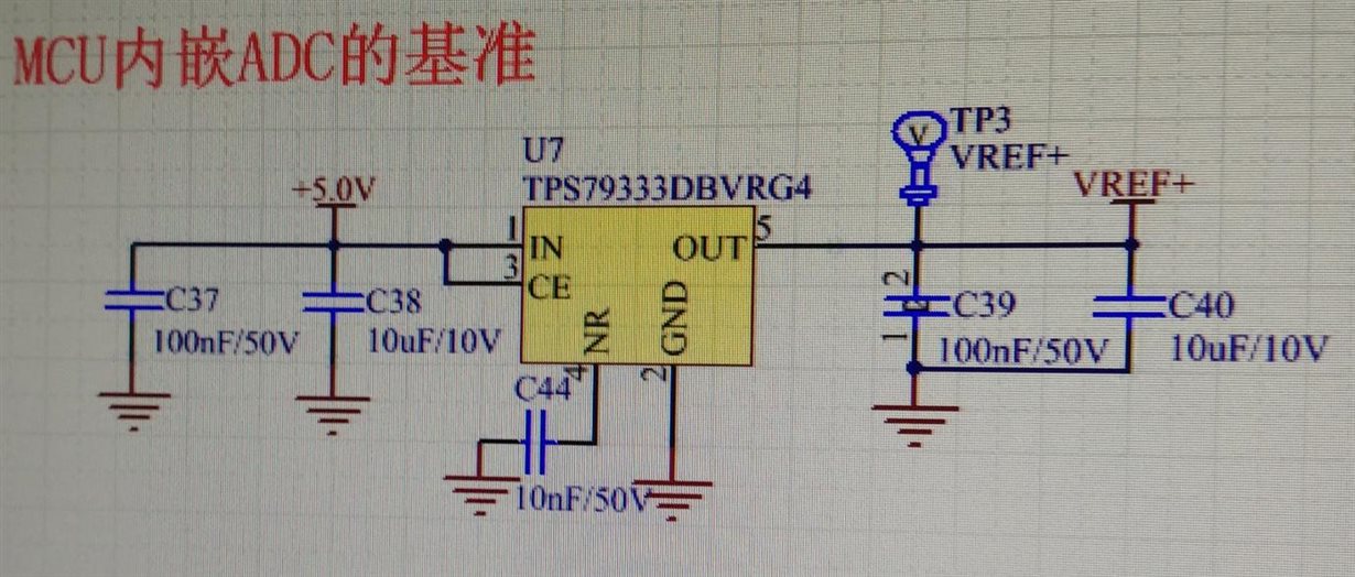

    Nothing stands out as being incorrect with your schematic or layout.  For the next steps, I would try measuring the different signals with an oscilloscope.  I would measure Vin and Vout.  I would also review if there were any fast transients in the system which could result in inductive ringing on Vin or Vout, and result in transient voltage below GND.  If those conditions exist then the device may have been damaged from exceeding abs max values.
