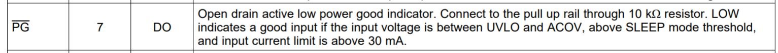

Hello I build the following circuit following the example given in the datasheet and tried to test it. For unknown reasons it isn’t charging the battery. To the contrary it discharges the battery, with nothing connected to SYS.
To test this circuit it was solder on an experimental board. K5 was replaced with a 10k resistor. Vusb is provided by a lab power supply, set on 5V. For the battery a 2000mAh LiPo is used, with a voltage of 3,9V.
The circuit shows following behavior:
Without battery:
                PG_N, Stat: blinking simulate. 800ms high 500ms low
                Vbat: ripples 4,2V-3,8V rise 50ms fall 850ms
                Vsys: same as Vbat
With battery
                STAT: high
                PG_N: short dim flashes. 2400ms between flashes
                Vbat = battery voltage
                Vsys = battery voltage
Am I missing something? Any input would be helpful.
