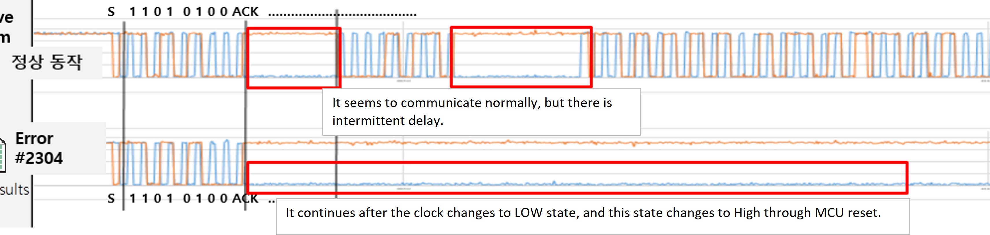

Please inquire about the cause of intermittent I2C read failure when the init reg value is set as follows.
Please check if there is a problem with the register value.

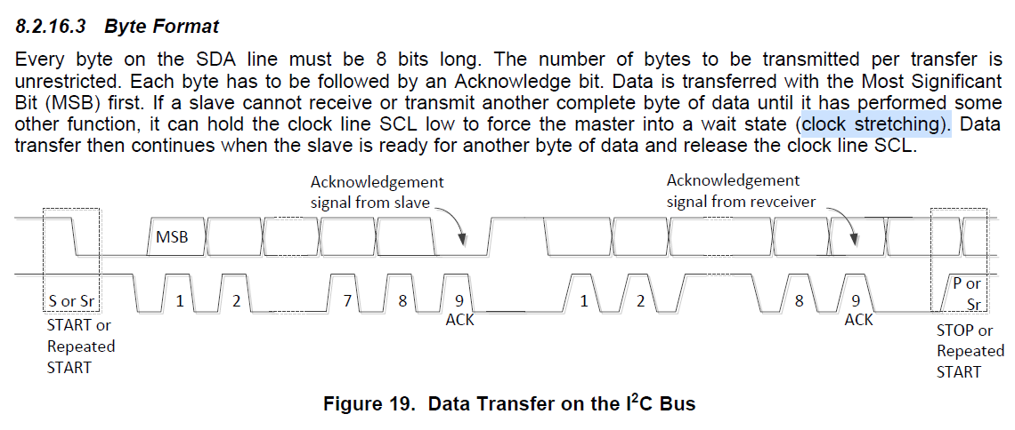

1. In some cases, I2C communication intermittently delays. Please check. (Refer to the waveform below)
2. The waveform below seems to be a symptom of clock stretching. Is it correct? What is the cause?
At this time, charging is operating normally. Is it normal operation?
What state should it be in order to be released?
This symptom is common in all samples.

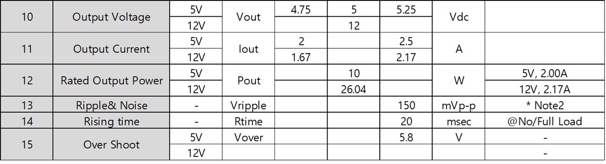

Sample conditions are as follows.
  • VBUS: 12V
  • IVBUS: 0.67mA
  • VBAT: 3.7V
  • IBAT: 2A
  • VSYS: 3.7V
  • ISYS: 11mA

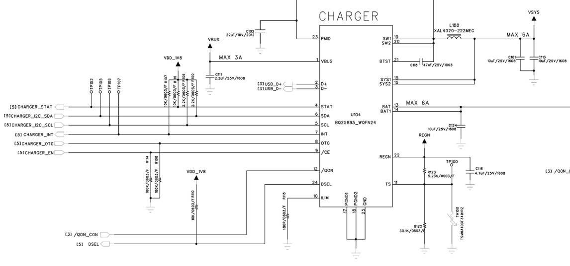

The peripheral circuit diagram of BQ25895 is as follows.
