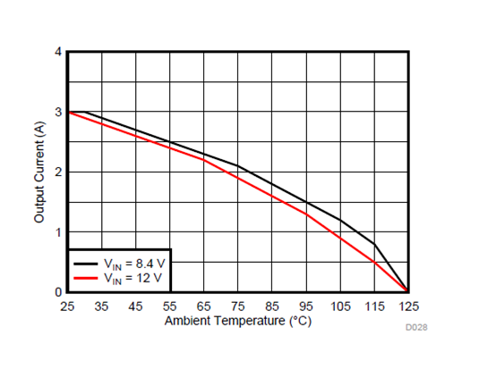

Could you provide Thermal Derating data at VOUT=5V?
There is the data at VOUT=3.3V on the datasheet.

See attached
