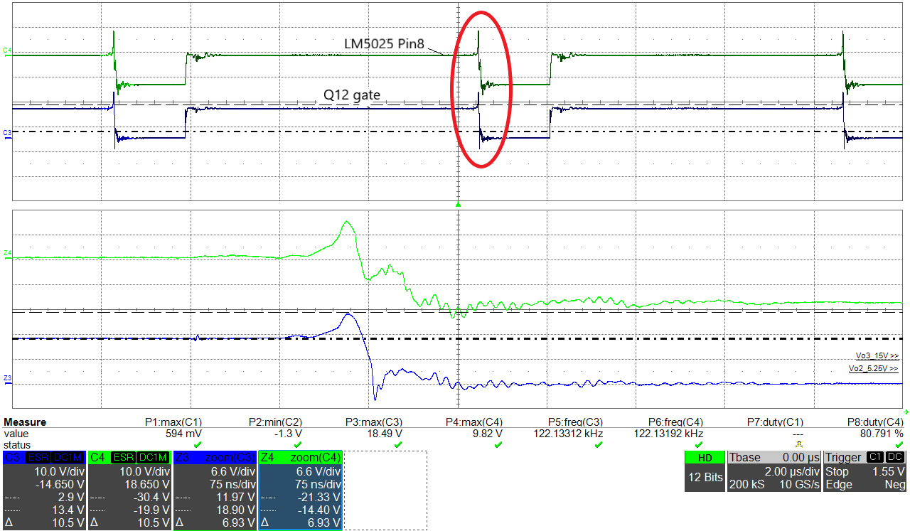

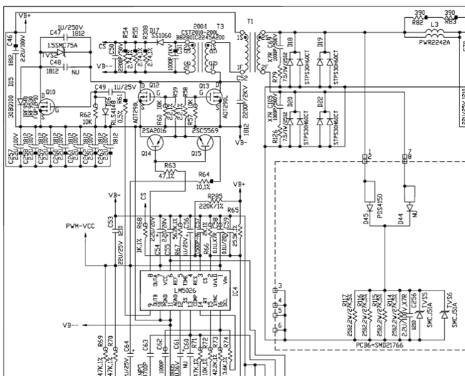

Hi
My customer used LM5026 to found the gate has a spike in the gate turn off.
We checked the gate Q12 gate and IC pin8 as the waveforms there has the same question,
Did these waveforms normal? Will this cause the risk of IC damage? thanks.
