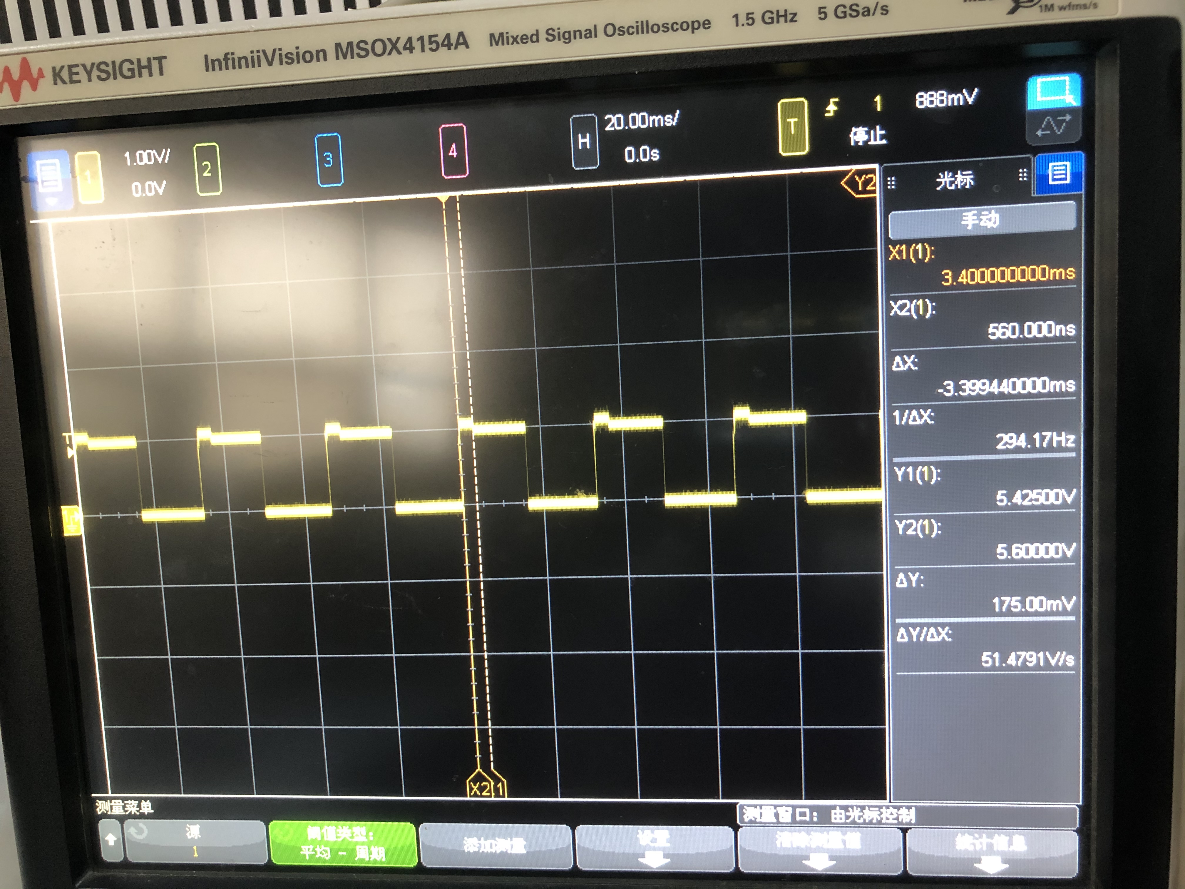

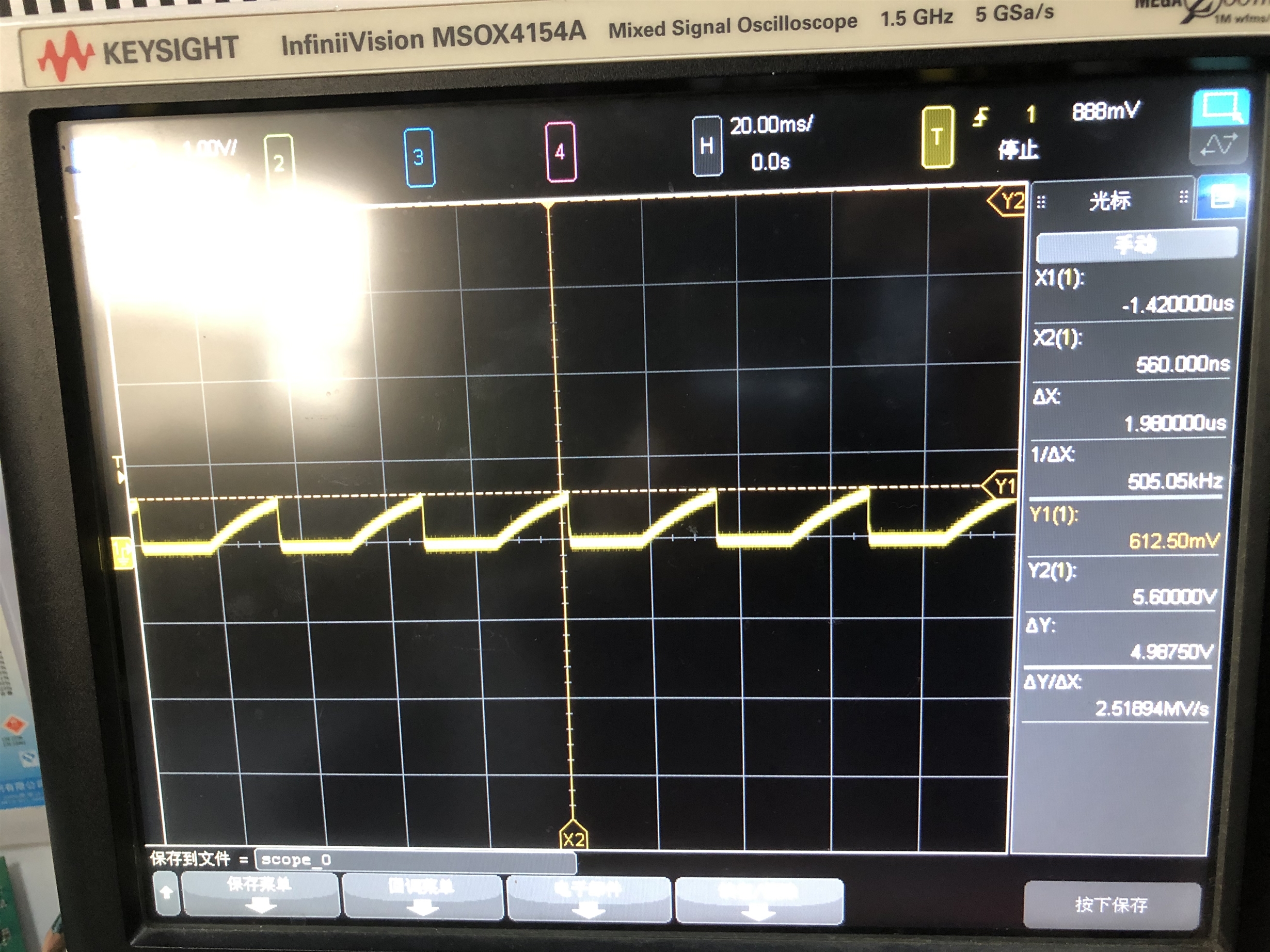

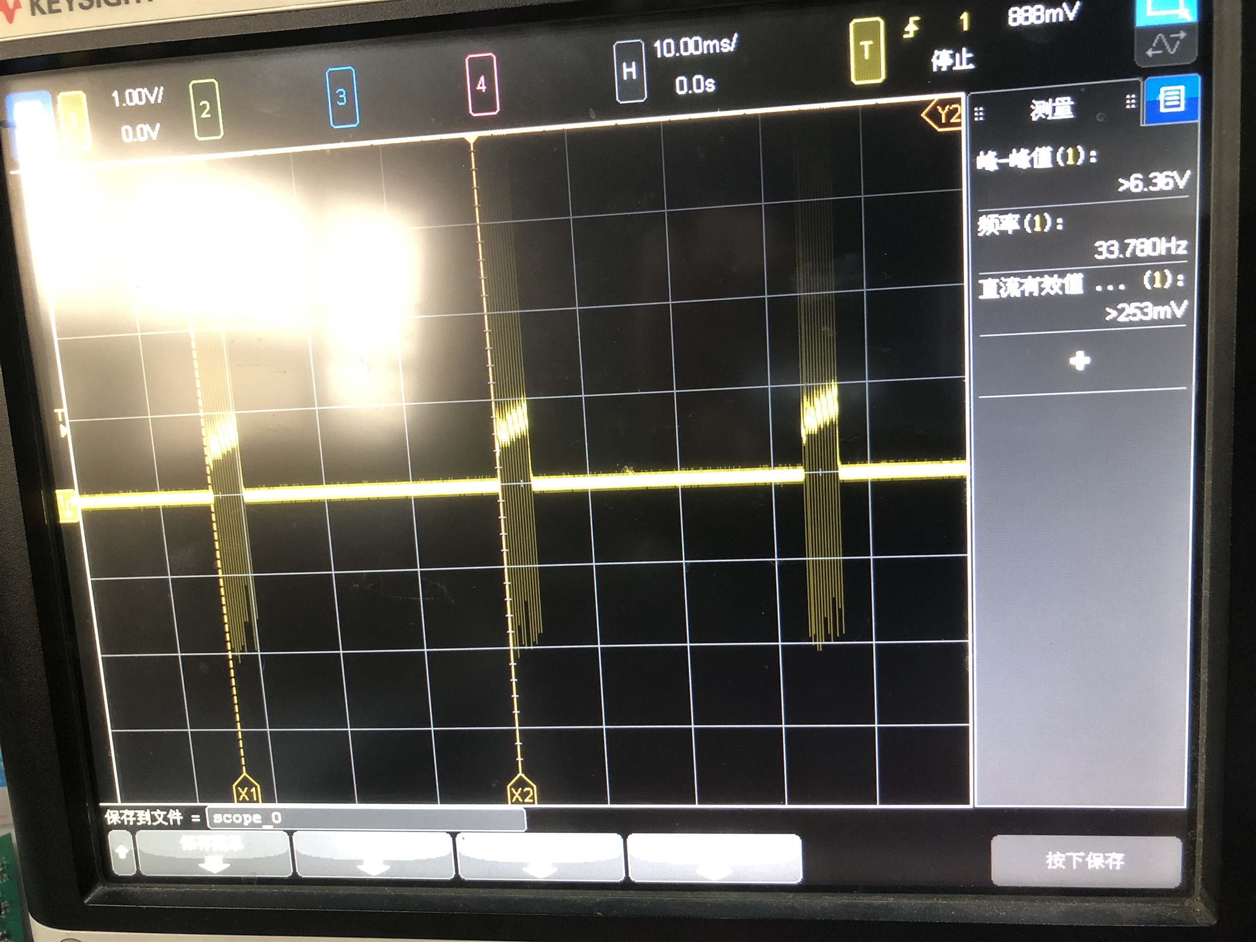

My customer tested PWM dimming in our EVM. They apply an external 30Hz PWM signal to our EN pin. But the customer found that PWM dimming can't work normally at first. When they remove C6 component, the PWM dimming works normally. But we don't understand why this cap has a impact to the PWM dimming. Could you please help analyze this issue?
When adding C6, the IADJ pin and LED+ waveform is as below,
IADJ,
LED+, the pulse voltage should be 5V, but currently the voltage is only around 0.6V.
After removing C6, the IADJ and LED+ waveform becomes normal.
IADJ, but still have a discontinuity.
Thanks & Best Regards,
Sherry
  • Hello Sherry,
    If you are PWM dimming at low frequency try using the UVLO pin for PWM instead.  The LM3409 goes into low power mode when the EN pin is low, this is causing Iadj to discharge C6 and have to recharge it when EN goes high.

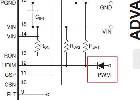

  • Hi Irwin,
    I have to add a diode at the UVLO pin as below, right? What is the function of the diode?

    Because there is some risk to achieve this function at UVLO pin. The PWM signal comes from image sensor's GPIO, and the voltage is 1.8V, and the maxim voltage of the GPIO is 3V. When doing some special test, the voltage of UVLO pin will be larger than 4V. In this way, the large voltage will comes to the sensor's GPIO pin through the diode, which may damage this GPIO pin. Therefore we can't use UVLO pin to achieve PWM dimming.

    You can remove C6.
    Also RUV1 limits the current that can get back to the GPIO pin, they can check how much current it can sink when high.  Another option is the drive the UVLO with a NPN or MOSFET such as the BSS123 (this will invert the PWM signal).
    The UVLO can also be clamped with a zener.
