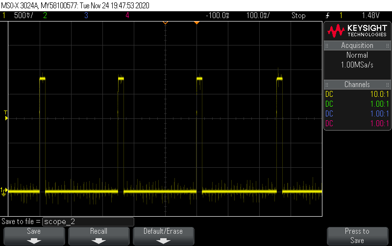

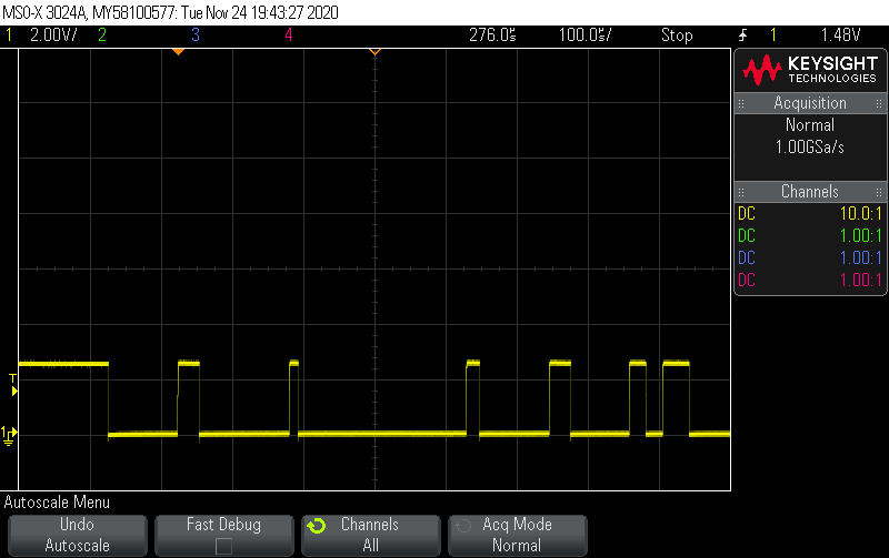

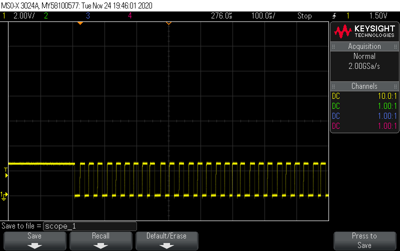

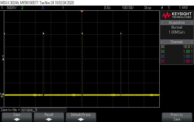

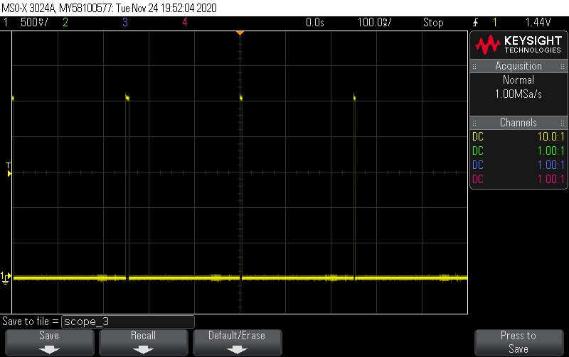

    Thank you very much for your reply. We changed the BQ76930 and removed the BJT which was connecting to CAP1 at the base (which controls the LEDs).  Now the voltage at CAP1 is 3.3V as expected.  However, bqStudio still doesn't recognise our device.
    We have also probed the SDA, SCL, ALERT and VEN and the signals look as expected which I assume means that there is communication between BQ78350 an BQ76930.  Probing at the SMBUS, the voltage if fixed high though.  We tested the EV2400 with the development board and it could recognise that device. Here are the scope images:
    SDA and SCL
    VEN and ALERT
    We have also grounded the SMBA which should be the default address.  I can't pinpoint what the problem is..
    EDIT:  We ended up changing the BQ78350-R1 as well an now it gets recognised!  It is strange though as the CAP1 shouldn't affect the gauge.  In any case, I do believe that current flowed through the base of that BJT and fried both ICs.
