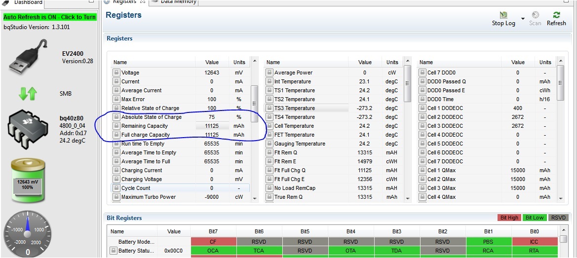

We are trying to generate the Golden file for 24V 15000 Mah Battey and all time the learning cycle is failing due to design capacity or for any other reason.
For the same batteries with the configuration of 24V 2600Mah (1p6s) Golden file generated with no issue.
We observed that the Full charge capacity is reduced to half of the Qmax we setting, pls let us know what the issue.

    The Above solution didn't worked, we have observed that in our 6s6p configuration all the series cells are not getting discharged to full(Only Port 6 is getting discharged for capacity )  and hence may the learning cycle fails. Attached are a couple of our log files. can you please analyze and let us know what is the issue.

    we made the learning cycle to  90% DOD but, the Learning cycle fails because of the below reasons
    1.FCC will get decreased by 2000 mah(while discharging FCC=14000 mah ,after the fully discharged FCC =11500mah)
    2.we charged the battery to 100% but fails to set the FC(fully charged)  flag because of   CTOS(charge time out) flag enabled.
