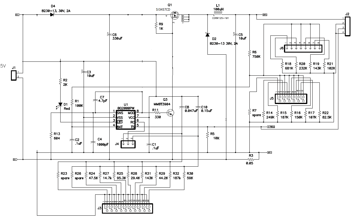

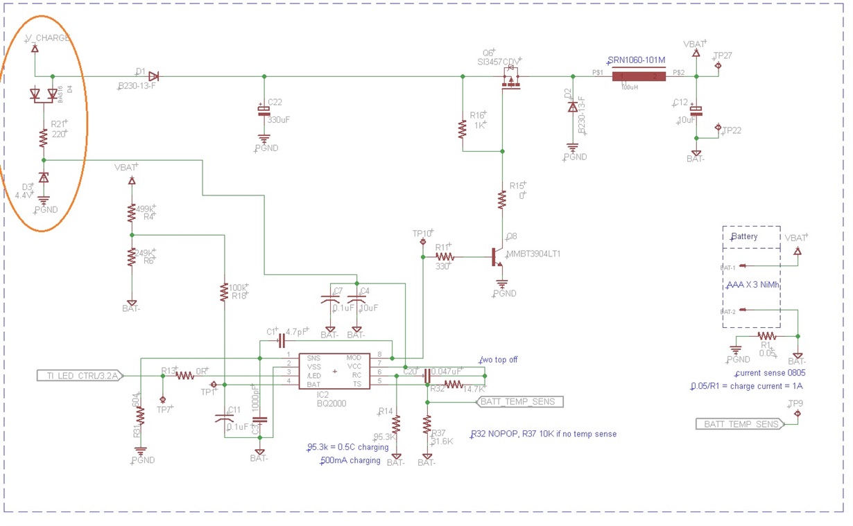

we went ahead to make the design as follows:
Input voltage is 5V via USB-C , charging 3 cell NiMh battery 3.6V 1100mAh , at 0.5C without topoff. The battery has no NTC hence 10k resistor pull down.
The PFET used is SI3457 as original 3455 is not available anymore, and fast switching transistors + circuitry removed.
The issue we are facing now is that this circuit "seems" to be able to charge a NiMh battery , because it is able to charge a battery from 3.9V to 4.16V within 5 minutes. However using an oscilloscope to check the /LED , MOD and RC pins, I don't see the waveforms as suggested in the datasheet.
1.) the LED doesn't change state at all despite the battery seemingly holding a higher voltage before /after / during charging.
2.) the MOD pin during charging is at around 4.6V , and after cease charging goes down to 0V. However I dont see any switching as in the datasheet, just a flat 4.6V.
3) the RC pin also shows no state changing, the datasheet indicates that it should be switching. 0.047uF and 95.3K used for 0.5C charging and no top off config.
I hoped I have provided sufficient information for you guys to provide some insight into if the situation is normal or not , any clues would be appreciated, thx.

  • Hi Pete,
      Can you show the waveform of RC, MOD, Output voltage and LED pin on scope capture as well? Please also share your schematic for me to review.

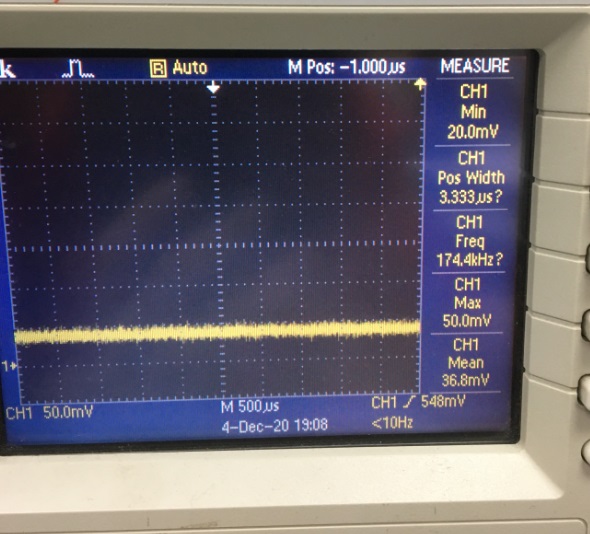

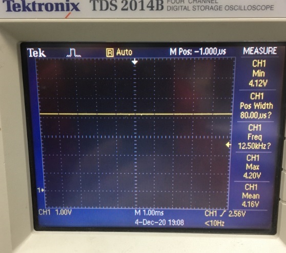

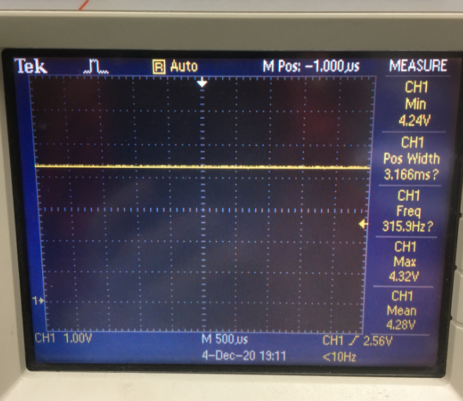

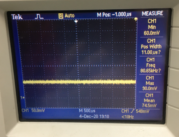

  • MOD
    RC
    LED
    VBAT
    Hi Kedar,
    attached are the requested files. On the side note, is the BQ2000 verified to work for 5V input supply ? Since this solution is a buck mode switching regulator, is it possible for nimh 3 cell to be charged using 5v ? thx

  • Hi Kedar,
    any update ?
    We did more tests and found something interesting.
    The power to the IC was modified as circled in orange above using a 4.4V zener ,resistor and schottky diode to do a voltage drop from the source, and we applied 6V to the circuit. When no battery was plugged, the power to the IC is 4.4V as the zener works as such. However, when the battery was plugged and then 6V power applied, the power to the IC dropped to 3.48V , but the charging seems to be working, and we could see  switching in the MOD pin around 125Hz 50% duty cycle. The charging lasted for 2 hours+ , but it did not stop charging the battery. The battery voltage reached around 4.6V and it then started to heat up, then the voltage of the battery gradually dropped to 4.45V. Can you help verify what is going on with the BQ2000, and what can be done for 5V power source to work, thx.

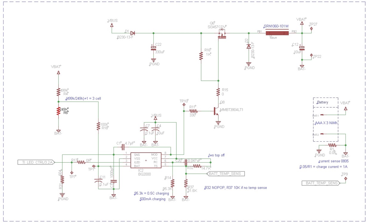

  • Hi Pete,
       When battery is fully charged, the battery will heat up and this is a possible termination mechanism. The BQ2000 can work with 5V input, as long as you remove the Q4, R10, D6 circuitry which acts like a linear regulator to regulate the VCC voltage to 5V. LED should not be lit during battery absent as the pin should be high impedance.
    What is the max charge regulation voltage of your 3s NIMH? As this is a buck charger, there is a certain threshold above the battery voltage, at which input voltage is required. You have to account for voltage drop in the input path, as the voltage on VCC close to the pin of the IC is what needs to be measured.
    Have you tested your configuration on the EVM? (with disconnecting the Q4, R10, D6 circuitry)
