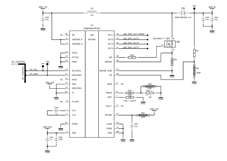

Hello.
On our display adapter board we are using LP8860 to drive backlight leds.

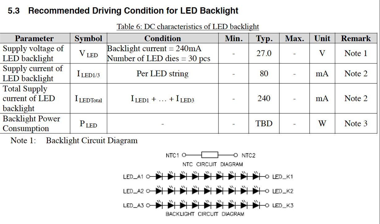

I have eeprom configured according to datasheed of LP8860 and our LCD:
  • 3 strings
  • 80mA via LED_CURRENT_CTRL and DRV_LED_CURRENT_SCALE
  • 27V via BOOST_INITIAL_VOLTAGE
But I am unable to lit the backilgt.
In status registers I have this:
staus = 0x08
fault = 0x20
LCD fault = 0x00
It seems that PL_FET_FAULT is active.
But we have another display (another LCD, 4 strings, 36V and LP8860 configured for this conditions) and it's backlight works normal with PL_FET_FAULT active. Thus I can't figure out is PL_FET_FAULT a reason for the backlight not working.
In addition I tried turn on adaptive boost (by EN_ADAP) -- still no luck, but LED Fault indicate that all three strings are in open condition.

Here is our schematic:
Here is LCD backlight documentation:
