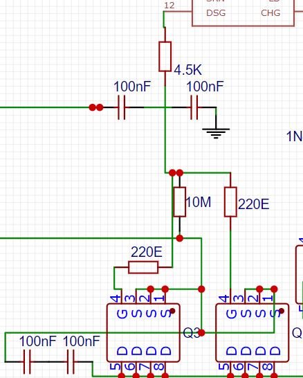

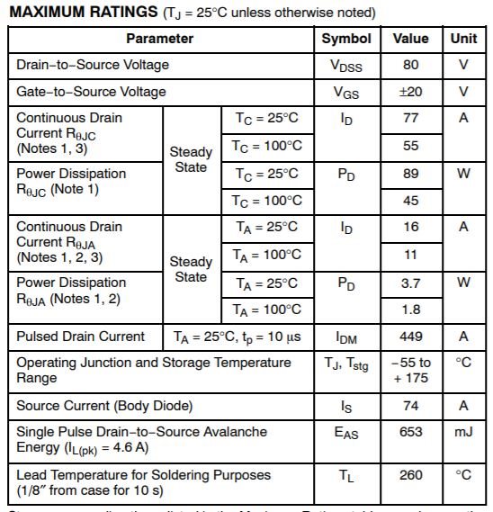

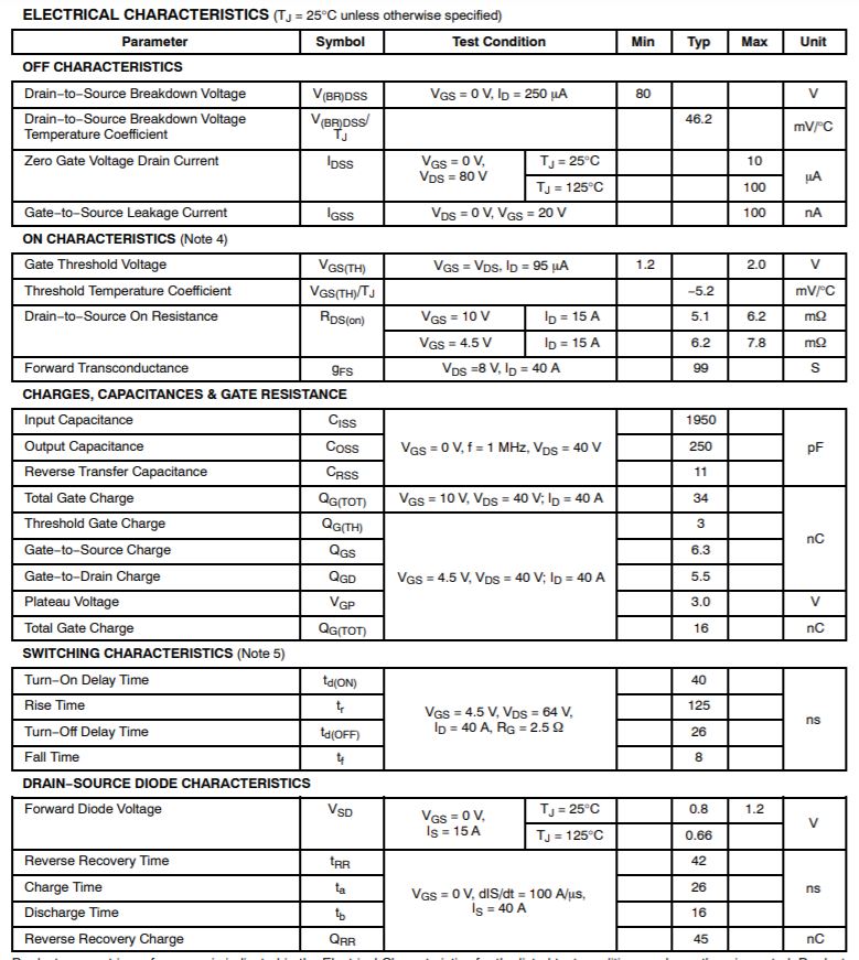

I are facing Mosfet burnout problem during Short Circuit, please let me know correct values for Rdsg,Rgs & Rchg,Rgs for Mosfet details attached.
I am using in 2 BQ7791501 in 10S configuration & using total 4 Mosfets, 2 for charging & 2 for discharging in parallel.
Everything was working good earlier, but now we have to replace Mosfets due to availability issues.
Is Rdsg=4.5k & Rgs=10Mohm ok?
Is Rchg=1k in series with Protection Circuit(Diode in Parallel 1M resistance) & Rgs=3Mohm ok?
Also Using 220E on each Mosfet Gate
Also Using Rld=450k,
& 2 100nF Capacitors in series on Source to Drain of Mosfet.
Please recommend any changes required
Also using RC filter on Sense Resistor.

    At short circuit the FETs will heat, if RDS on is higher on the new FET it will be hotter and may be at risk.  Of course check the current capability of the FETsjl
    The Ciss will act with the RDSG (4.5k in the picture) above to set the turn off.  For the new FETs you may need a faster turn off.
    A fast turn off can excite the cell inductance and cause a large voltage rise on the cells, PACK+ and through the short to PACK-.  The FET may go into avalanche and must take the power/energy if it does.  Sometimes too fast of a turn off is bad for the system, but too slow will heat the FETs.   If the PACK+ voltage spike is very high at the SCD event it may be switching too fast and breaking the FETs from too much avalanche energy. The 4.5k RDSG may need to be larger.  If there is no voltage spike at turn off  the FETs may be switching too slowly heating and burning, the 4.5k RDSG may need to be smaller.  Check the FET ratings compared to the measurements during the SCD event.
