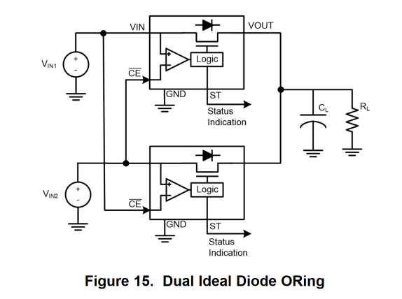

    Yes actually it is an RPP.
    By searching a bit in your product selection in power management I found the LM74610 and LM66100 which I can use for my purpose. I think LM66100 is suitable for my application for its cost efficiency, minimal design and power consumption (quiescent current is less than 1µA in normal conditions).
    I can use it this way :
    But I'm not sure about two things
    One is the pulse/peak current that this switch can provide :
    I see in the datasheet page 4 in 6.1 section : Maximum Pulsed Switch Current (≤120 ms, 2% Duty Cycle) : 2.5A
    While, my board can have current bursts of 2A due to a cellular module in GPRS mode. The pulse width is 611µs every 4.46ms
    I don't know if this is critical for my application's current specs.
    The other is that Vin1 and Vin2 are typically the same :
    In normal operation, will the two LM66100 be ON or just one ? How the setup above can deal with two identical power levels ?
    Is there any other things I should take into consideration ?
    Would this solution work ?

    For your case, I would recommend the BQ77915 battery protector.
