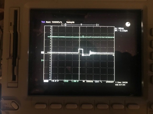

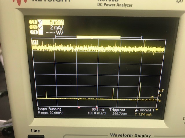

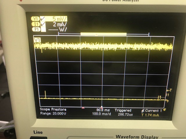

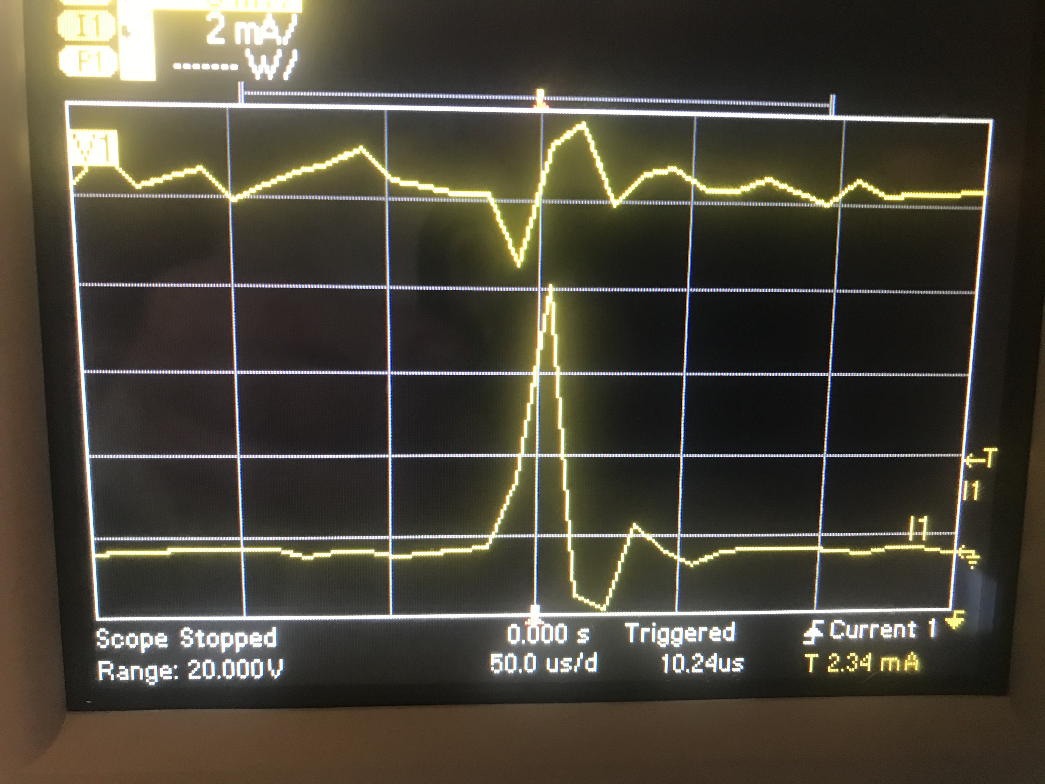

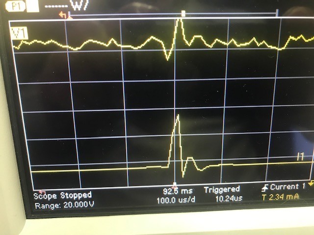

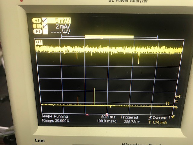

I am using the TPS62745 in a low current design, and every so often, I get a large (> 5mA) current spike.  The period of the spike seems to shorten as load increases.  Also, over multiple units, the period varies.  I suspect the TPS62745 because the circuit is broken before any of the down line circuits (only the power subsystem) and I can still observe these spikes.
Anyone have ideas of what is possibly occurring ??
  • More accurately, I should have said : The period between  the spikes seems to shorten as load increases.
  • Ken,
    Can you please share the design schematic if possible? Also, can you provide inputs on what you are measuring as V1 and I1 in the scope shot above? Is it possible to share a few more cycles of data?
    Amod

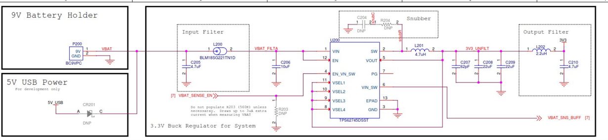

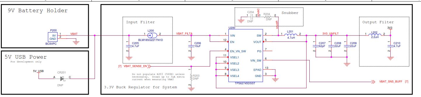

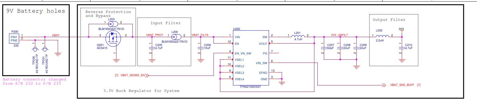

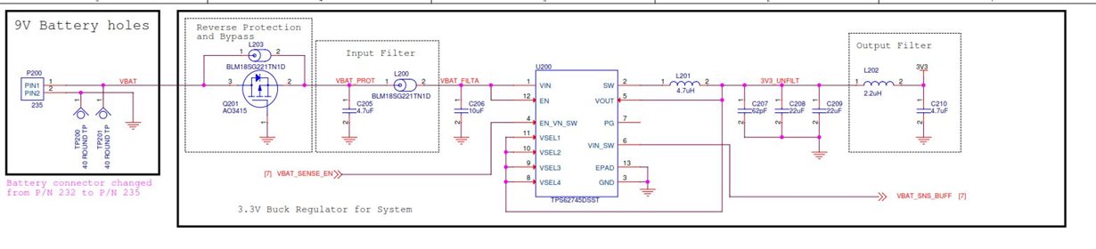

  • Certainly, the power supply section is :
    The Battery is your typical off-the-shelf 9V alkaline battery
    And I am using the scope function of an Keysight N6705B DC Power Analyzer
    Not sure what you mean by a "few more cycles" , these spikes are pseudo-random,  I do have a short video :

  • Ken,
    Could you please provide a waveform with a zoomed out (longer time step)?
    What Amod and I are wondering is how much time is there between current spikes.
    It would  also be good to know if this time changes with load.
    Additionally, would it also be possible to get waveforms for the SW and Vout when the spike occurs?
    Lastly, what is the typical load for this application?
    Thank you,
    -Matt

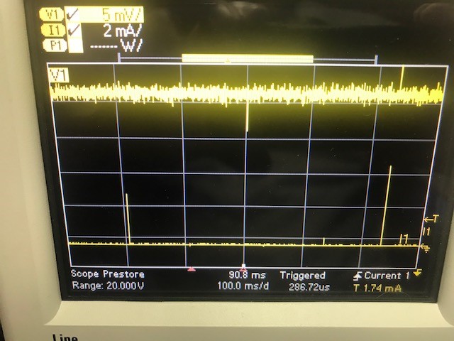

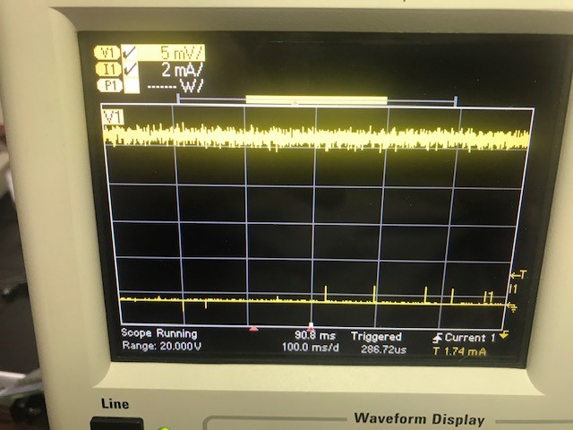

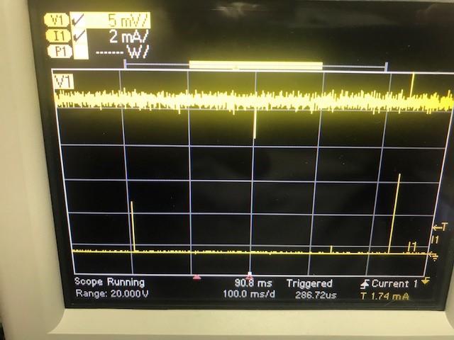

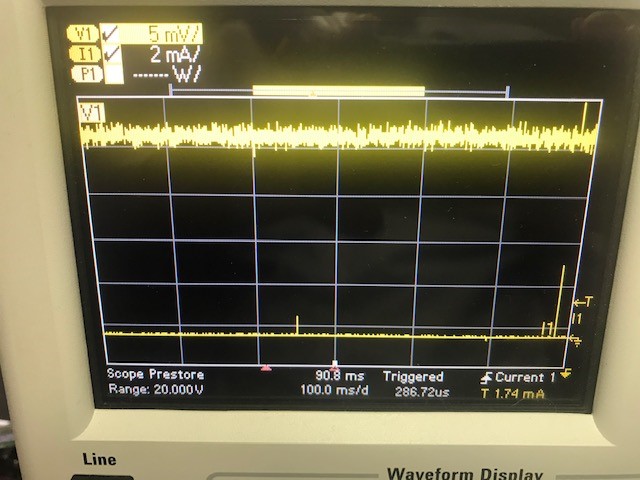

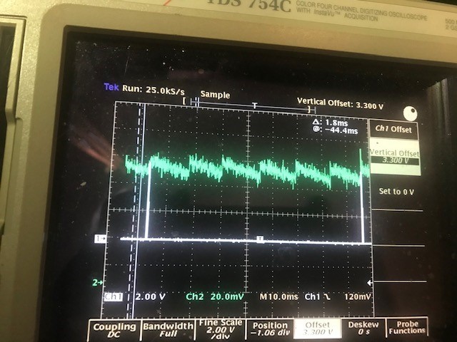

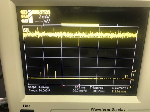

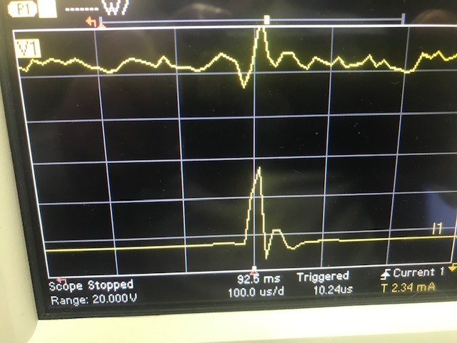

  • Greetings Matt and Amod,
    I have attached 8 "capture" and 2 "zoom" pictures.  The capture shows how the spikes are random/pseudo-random.  It is anecdotal, but my observation is that the rate of spikes do appear to increase with an increase in load.  These measurements are done while in "sleep" mode where the current draw is in the 1-2 uA range.
    I'm not sure  how, on this unit, to include the Vout and SW readings, I will look into that.

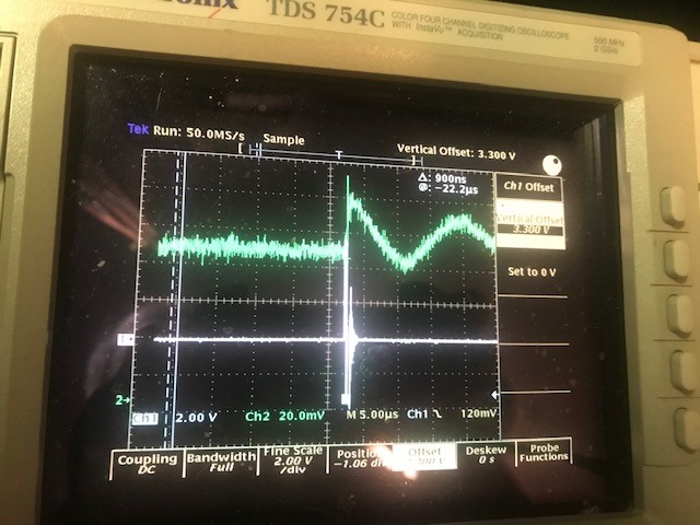

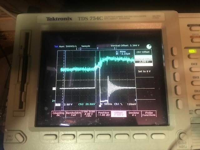

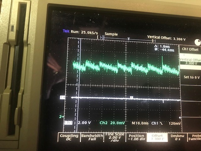

  • I was able to get SW and Vout captured using a Tektronics TDS754C scope.  The "white" signal (the one that has a step) is Channel 1 and is the SW pin of the Buck converter.  The green (virtually flat) signal is Channel 2 and is Vout :
  • Ken,
    This is the expected switching signal on SW during very light load operation, and you will see a current spike associated with each of these pulses.  If possible, I would recommend capturing the current spike with a similar scope resolution (500ns/div) to confirm the current spikes only occurs during SW pulse.
    I would also expect that if you were to capture Vout with an AC coupled trace at ~10mV/div resolution you would see a more defined voltage ripple that corresponds with this SW pulse.
    This occasional switching pulse is required to keep the output voltage in regulation, and the spike of current results from the inductor's di/dt during switching and the subsequent output capacitor's dv/dt.
    Sincerely,
    -Matt
  • Matt,
    Thanks for the input.  However, a couple of points not mentioned so far.  The spikes are occurring on a "second generation" of this design.  The first generation does not experience the current spikes.   Also, I am observing  > 5 ma current spikes at times on the second generation design.
    Given this is what is being observed, and assuming the spikes are indeed a result of regulation, is there a way to minimize or mitigate the spikes to reduce the overall current draw over time ?   This design is meant to last 5 years on a 9v battery using extremely low current in a sleep mode.

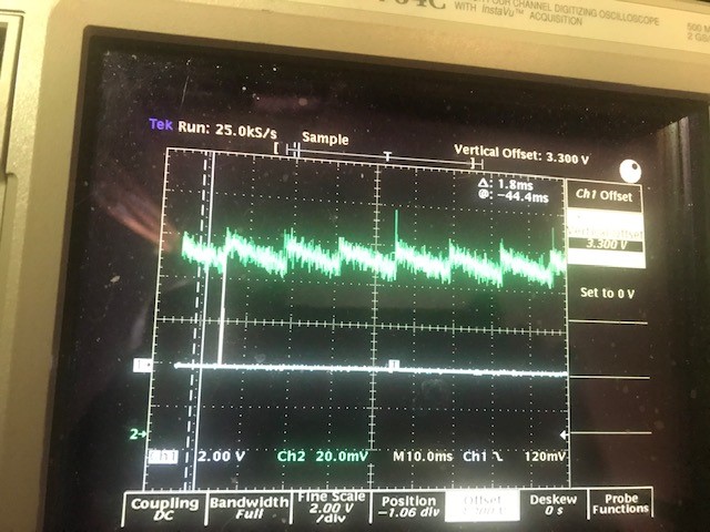

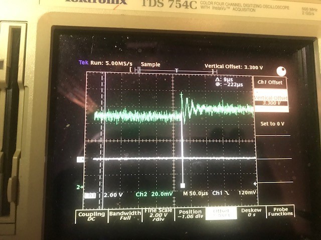

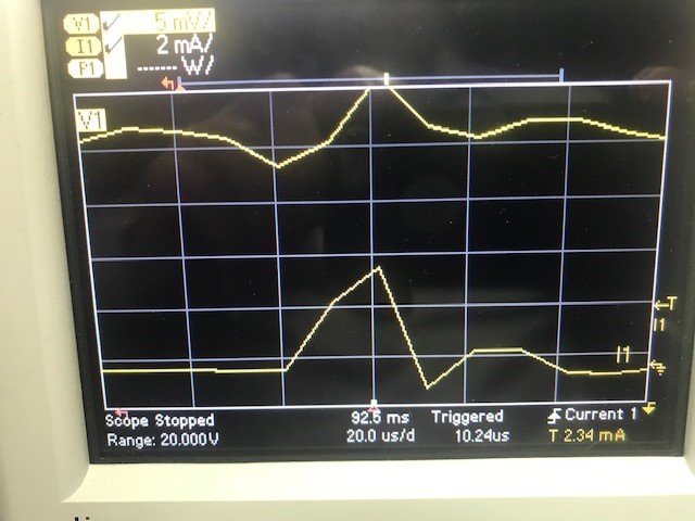

  • I have some more traces :
    Now, here's a couple that are unusual :
  • Ken,
    This is the behavior that I would expect to see.  Although, I do suspect that subsequent SW pulses are "missing" due to the scope aliasing the high freq SW pulses relative to the low frequency Vout ripple.
    Based on the SW waveforms above, you can calculate the expected inductor ripple current as:
    ILpeak = ton * (Vin-Vout) / L = 300ns * (6v-3.3v) / 4.7uH = 172mA
    Note: I used 6V for Vin based on the peak SW voltage in the waveform.
    Taking into account the ~15ms and ~0.8us SW switching periods, you can approximate the average current draw as:
    Iavg = 172mA / 2 * 0.8us / 15ms = ~5uA
    Note: for Vin = 9V, you can expect to see a higher ILpeak, but this will be offset by longer periods between SW pulses (ie ~15ms -> ~30ms)
    In general the input capacitance should "absorb" these current spikes.  Is it possible that the input caps have been reduced on the second gen design?
    Was anything else changed in this design revision?
    Increasing the input capacitor should reduce the magnitude of any current spikes seen at the battery.
    Alternatively, you can also try increasing the inductor value as this will reduce the peak current generated on each switching cycle.

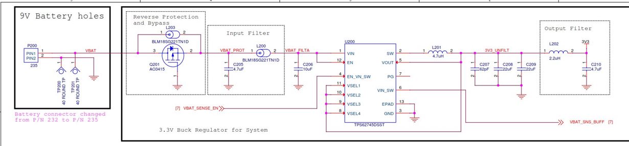

  • Matt,

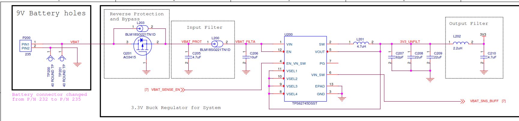

    Here is the Power sub-system for Generation 1 :
    and the power sub-system for Generation 2 :
    Please note, for Generation 2 , the FET Q201 is not installed

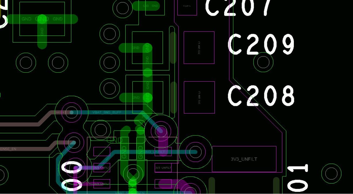

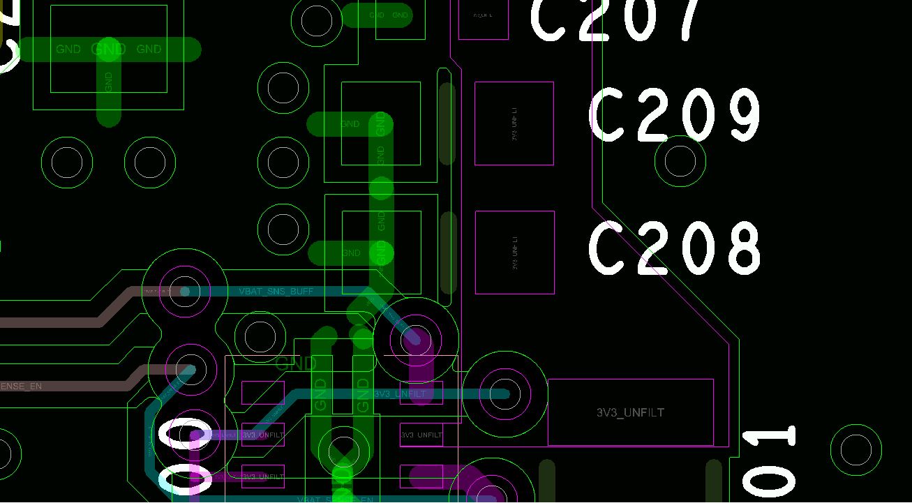

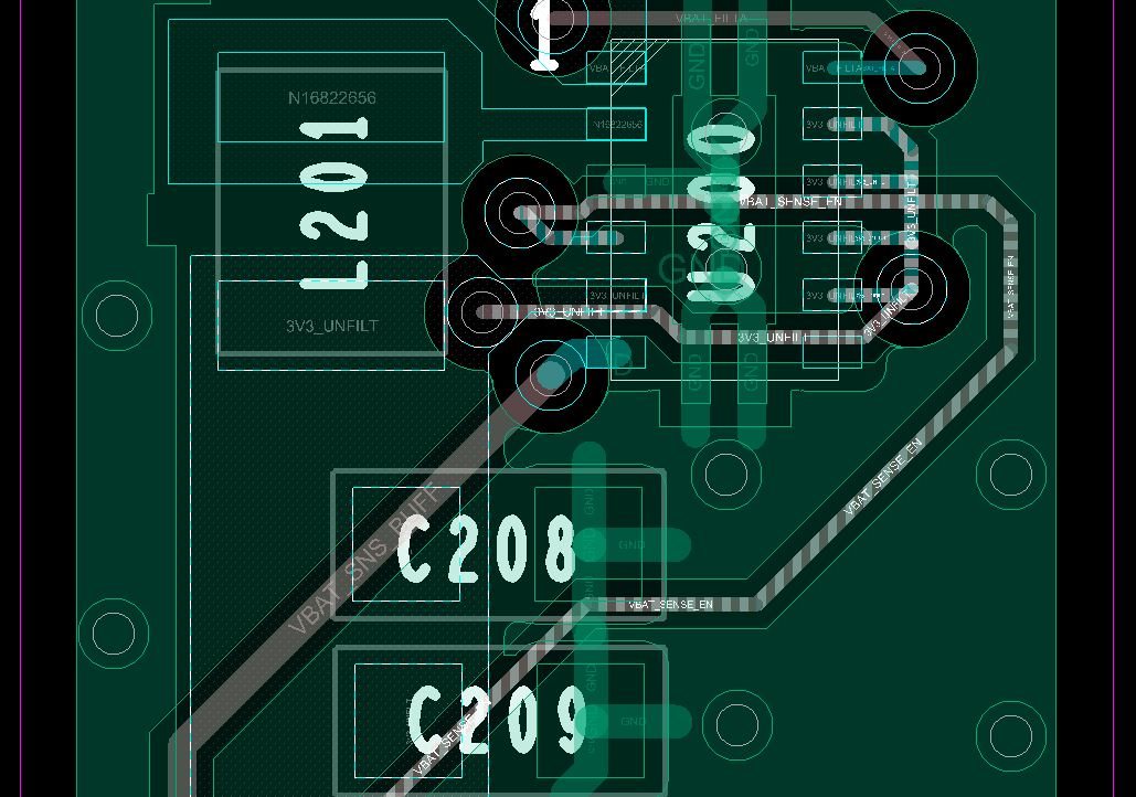

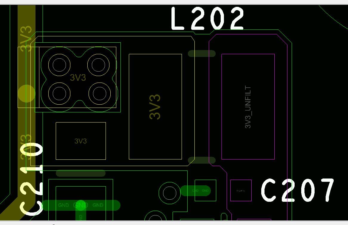

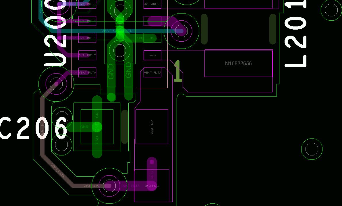

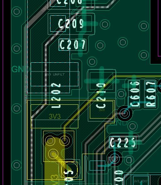

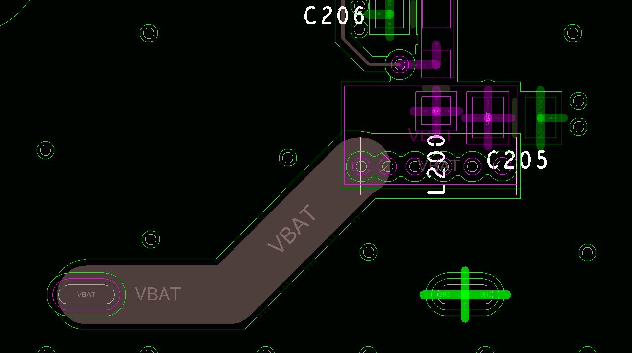

  • Here are comparisons to the "Generation 1" and "Generation 2" layouts ::
    Generation 1 :
    and Generation 2 :
  • To answer a previous question, in both generations, in the input capacitance is 10uF.
    A note on my experimentation.  Increasing the input capacitance from 10uF to 22uF had a slight improvement.
    Changing the output capacitors (C208 & C209) from 22uF (each) to 10uF (each) had a noticeable improvement
