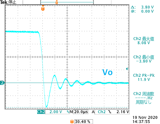

The datasheet 6.1 note (2) says “OUT will withstand transients to -2V for 1ms or less.
On my customer board, the OUT transients to -4V for ~10us.
Could this damage TPS2490 or should this be OK?
K.Hirano
  • Hi Hirano,
    I would suggest to use a schottky diode at the output to clamp the voltage within -2V spec.
    Let us know the system voltage and max load current details to suggest part number for the schottky diode
