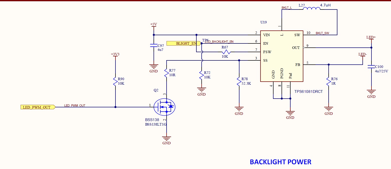

TPS61081: TPS61081 Led Driver PWM problem
Part Number: TPS61081
I am using TPS61081DRCT for 10v/270mA backlight. When the device is turn on, If PWM is full on , it is no problem.
But After the device is turn on, If pwm is changed, TPS61081 and output Inductor is very hot. And Backlight is flicker.
After that, Although PWM is full on, Backlight is not changed.
