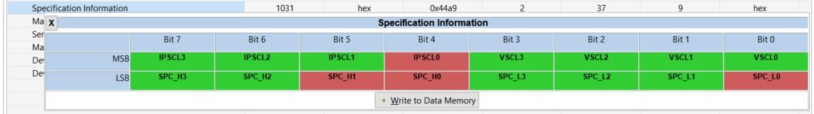

    Asl changed the sense resistor settings to 0,1milli-ohm and with that I changed the IPSCL1and IPSCL0 in tje SBSconfiguration  both to 1.

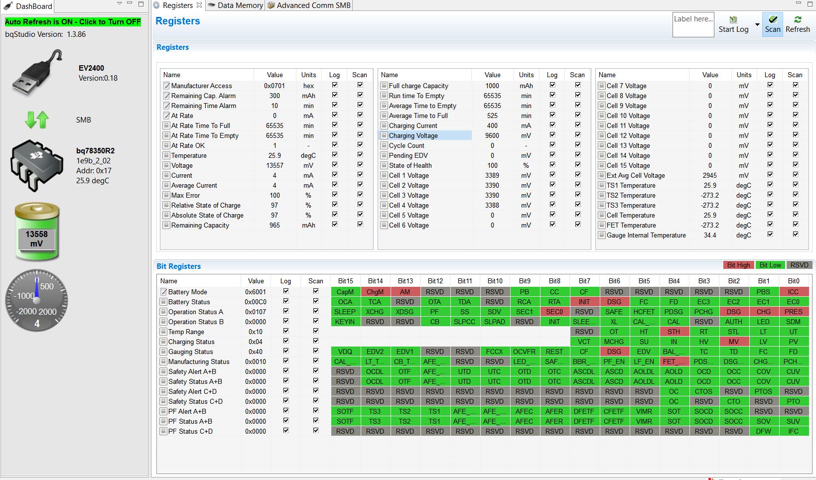

  • In the image if BQstudio I'm charging the battery with 4Amps the meter give in my opinion the correct value. the voltage level during charging is at that moment 13558mVolt  that is normal. But the reading at the registers charging voltage is 9600mV and that is aslo strange . the remainnig capacitiy is 96% and is not correct. it is  less then that. After a time I get an OC and after a period it's stops charging although It have never reached it's end point in my cass it should end around the voltage level 14,6Volt.
    kind regards

  • Hi Rens,
    I'm not sure if your OCDL question was answered yet. An OCD fault will recover if the recovery conditions are met (described in section 3.5 of the TRM). Each time the OCD protection is triggered again (OCD recovers and then new OCD is triggered), the OCDL counter increments. Once it reaches the counter limit (OCD has occurred and recovered multiple times), then the OCDL protection will trigger.
    OCDL must also be enabled in the Enabled Protections registers. From your .gg file, it looks like this bit is not set.
    I checked one of the log files and the discharge is getting stopped due to the CUV protection - this is set to 2400mV in your .gg file. It is not starting from fully charged - your battery should be charged to 3.65V according to its datasheet. The log files for the GPCCEDV tool should be a full discharge from fully charged.
    Matt

    I have charged the battery completly stuffed to 3750Volt with a LiFePO4 charger. then It stops an I let it rest for15 minutes to some hours and the voltage drops between 3650mV to 3383mV depending of the duration of rest period.The gauge meter is showing complete full and Remainig capacity is showing 102mAh(in my case 10Amps). Learnig Full Charge Capacity is showing now fater 9 complete cycles 104mAh . When I then apply a load to the (In have set the OCD back to 1000mA, in my case is that 100A).the Ramaing Capacity still drops in letsay 30 seconds to almost 0 and after1 minute it is zero, but  the battery is still able to deliver energy of almost 10Ah.
    Regarding your instruction to folow the  GPCCEDV I had not there for I started to create the data with BQstudio interfacing my circuit and measured six cycles . then I creded the file GPCPackaged.zip with zeven files in itan d uploaded it to "GPC Tool - Upload" . But I receive mutiple times the statment:

    is my gauging not working because of current scaling i used? In the SBS configuration IPSCL0 set to 1, due to the high current I use and small sensing resitor of 0,1mohm.

  • Hi Rens,
    I'm not sure you are interpreting OCDL correctly. It is not just a longer version of OCD - it is a way to prevent getting stuck in an endless loop where the OCD is triggering and recovering. It can be used to keep the DSG FET disabled for a longer time period. For example, if there is a weak short on the battery the OCDL protection can prevent continuously cycling into and out of OCD.
    I took a quick look at the files that were submitted to the GPCCEDV tool. I think one issue is that the voltage is for one cell, but the config file specifies 4 cells. I think you either need to use the total pack voltage in the log files or change the config file to 1 cell. Also, I noticed one of the files has a bad temperature reading for one row (lowtemp_highrate line 106). I suggest quickly plotting each of the log files and remove any discontinuities that may cause issues with the tool.
    I took a quick look at the .gg.csv file. The EDV_CMP bit is set to zero which means it will use the fixed EDV values. When the cell voltage falls below Fixed EDV2, the SOC will immediately jump down to 7%. EDV1 will change the SOC to 3%. After you successfully generate the CEDV parameters, you can update the CEDV parameters in data flash and then set the EDV_CMP bit to '1'. This should help the gauging accuracy.
