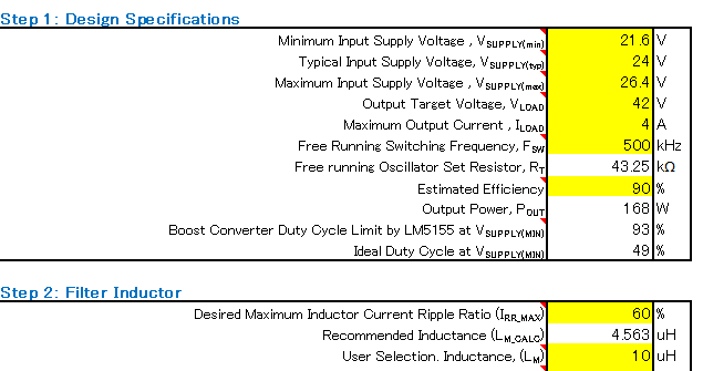

I'm using the calculator as below;
However, LM_CALC result is not matched my calculation.
=26.4*0.37/(6.364*0.6*500kHz) = 5.1uH
Is my calculation incorrect?
  • Hi Kuramochi Tadahiko,
    Thanks for reaching out with your questions and for considering the LM5155 in your design.
    There is an issue in this version of the calculator when the duty cycle for the boost converter doesn't reach 33% duty cycle. This will be updated in the next revision of the calculator. You r calculation is correct.
    Looking at the design specification I think using s synchronous boost controller might fit the application better as the power is 168W. Please take a look at the LM5122.
    Please let me know if you have any questions.
    Garrett
