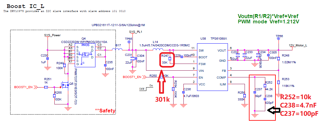

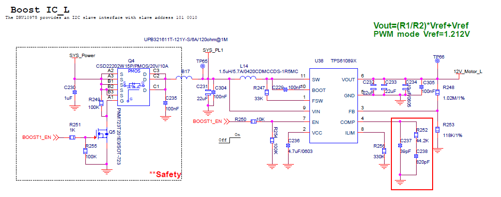

TPS61089X schematic review,
1.Please focus on the accuracy of the PIN4 COMP circuit.
2.Are there any problems with the selection of other components?
Hi River,
Could you please attach the schematic?
It depend on the output load current. generally for the motor application, at least 47uF EL cap is added at the output side.
