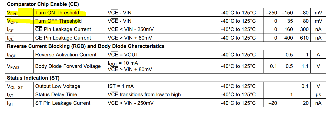

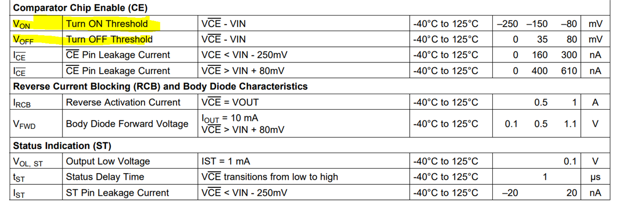

In normal operation, will both LM66100 be ON or just one ? How the setup above can deal with two identical power levels ?
    Only One can be on in normal operation as the comparators have hysteresis, see the different between Von/Voff.
    If both voltages are equal, it will depend on which comes online first
    Please let me know any further questions on this,
    Best
    Dimitri

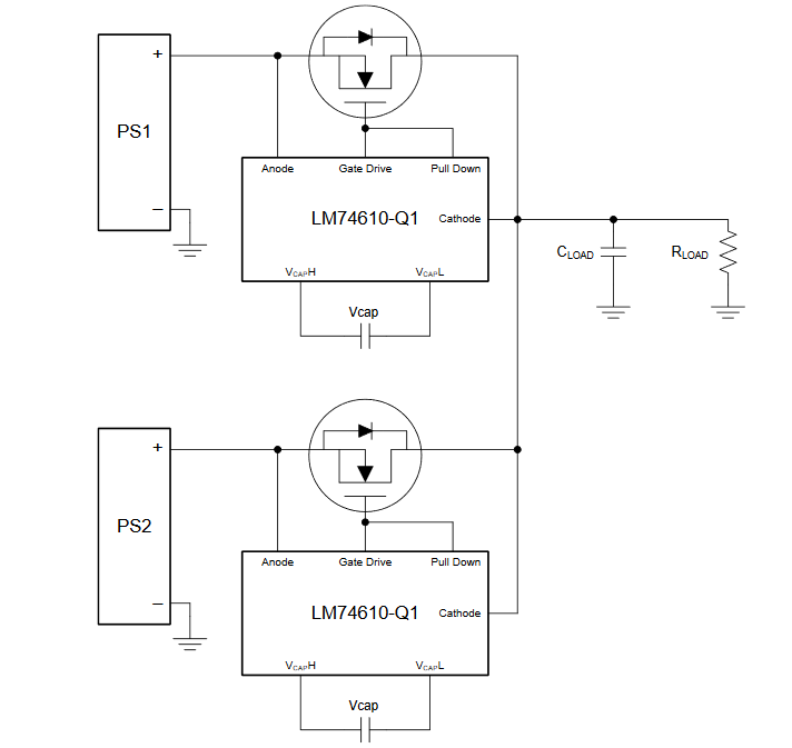

    I am thinking about the LM74610-Q1 which can drive an external NFET and thus can handle the 2 Amps bursts or more.
    By using it in this configuration :
    If I understand correctly the functioning :
    At startup PS1 and PS2 are equal, so the output will take the first supply plugged in.
    Lets say PS1 is the supply that came in first :
    So when PS1 drops and PS1 becomes less than PS2. the device switches to PS2 and vice versa until the two supplies drop to "0V"
    Is it correct ?
    And is there any drawbacks or risks of this configuration ?

  • Understand on the current consumption issue.
    The voltages being exactly equal is very unlikely. Since both battery banks are equal, is there a certain battery bank which you would like to prioritize, even if its voltage is lower than the other?
    If you don't need to prioritize one pack over the other then there is no issues with your configuration.
