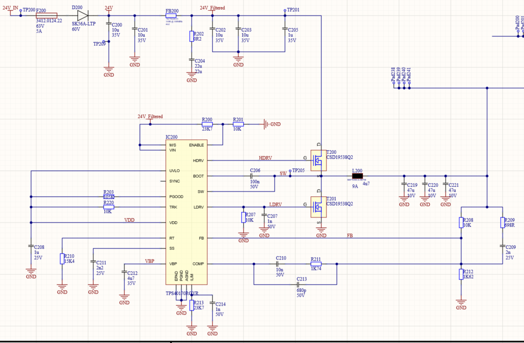

I made some prototypes base on the controller above and as can be seen in the picture joined. By first powering the board with 24V, we do have overcurrent by soft start as Vss was switching between 2,5V and 300mV and I change the Rilim to allow 8A and the capacitor and resistor on the gate of low side transistor. and everything was working so far as expected.
After some powering some other board, they work for about 2min and the following happen:
  • on one board they were short on GND and 4,3V. Trying to troubleshoot by removing all the capacitors on the bank, the short was persistent. I remove the controller, inductor, and transistors, They were not short on the complete path anymore. but after soldering all the components, it works for a few min again and goes in short. => what could be the cause? joined is layout and schematic.
  • on another board, the short occurs between 24_filtered and sw. I measure the voltage on sw expecting a voltage above 100V as specified in the datasheet of the transistor, but it is maximum 30V.  there is no more 8V at Vbp and 3,3V at Vdd. implying no LDRV and HDRV PWM. These errors occur on most of the develop board. I have analyze the board as my design was mostly taken from web bench. I decided to change the resistor on the enable pin to 2,6Mohm to limit the current to enable pin to 10µA aber no change. => could somebody tell me if he does have the same error with the chip??
  • on another board the board has been working for more than 3hours and short occur. my fuse just burns. after troubleshooting, I came out with short between GND and sw pin.
    It comes out that I am having anyhow always short on different path of the dcdc controller. I would be delighted to get any help in troubleshooting or resolving this issue.
    • thanks for your time and waiting to hear tonight from you.

    These CSD19538Q2 FETs are very small package (SON 2 x 2mm) with high Rdson -- are they getting hot?
    Please check component selection using the TPS40170 Excel quickstart calculator (the LM5145 calculator also works as it's the next gen part to the TPS40170 with the same voltage-mode feedforward gain). These files are available in the respective product folders. Just make sure to derate the ceramic Cout value for applied voltage and include any downstream caps not shown in the schematic.
    If the problem persists, please send switching waveforms and the completed quickstart file for review. Note the SS cap at 2.2nF is low here too, try increasing that for a more reasonable 1-5ms SS time.
