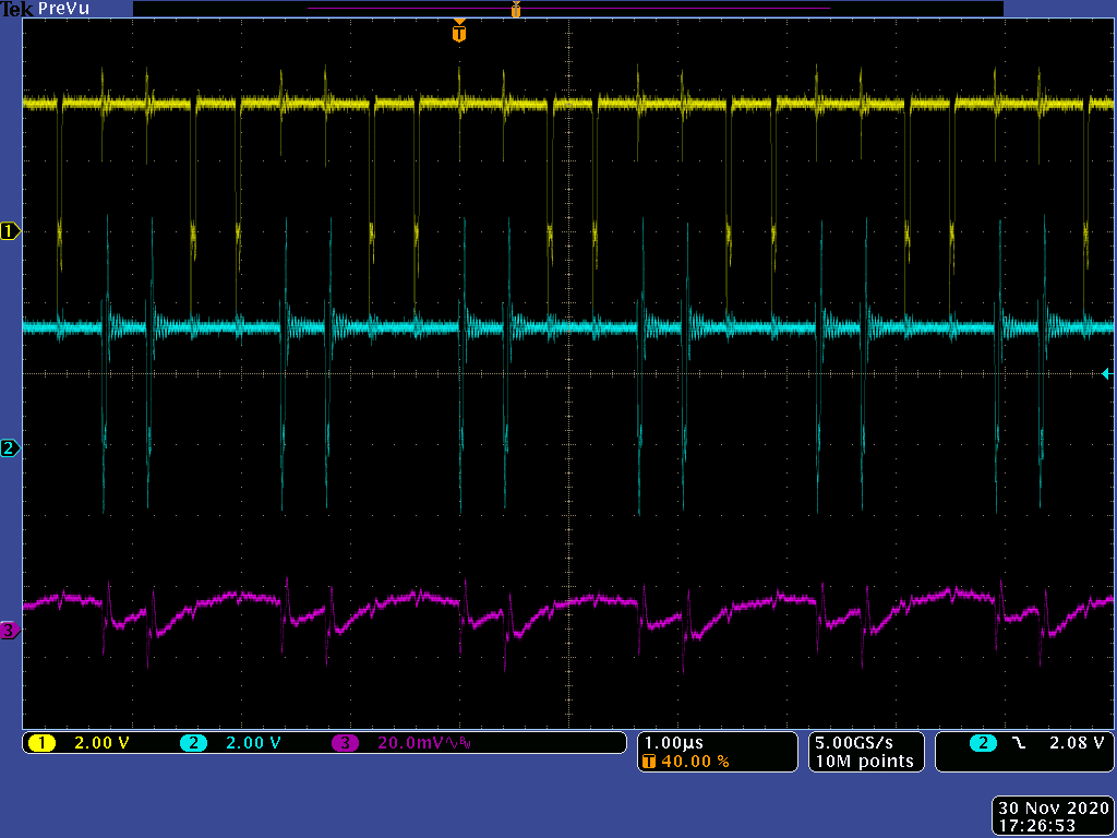

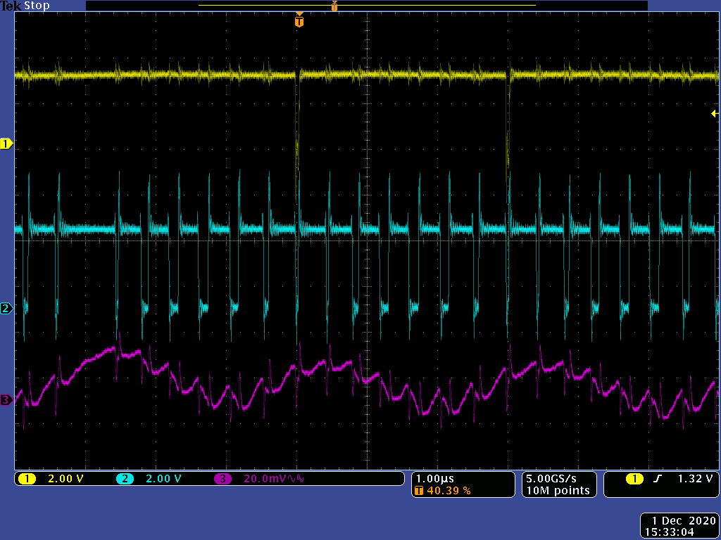

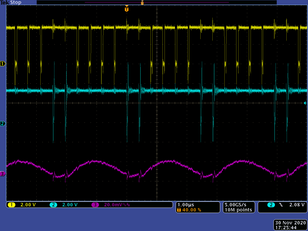

  • Hi User,
    CH1:L1, CH2:L2, CH3: Vout(AC)
    Vin=3.0V, Vout=3.3V @ Iout=0.5A
    Vin=3.0V, Vout=3.3V @ Iout=1A
    Vin=3.7V, Vout=3.3V @ Iout=0.5A
    Vin=3.7V, Vout=3.3V @ Iout=1A
    The ripple is up to 40mV because the device works in Buck Boost mode and the control is not very stable, and it is hard to make compensation. If you need better performance, you can choose TPS638xx series like TPS63802 or TPS63805.

  • Hi User,
    When Io=1A, Vin=2.9V, the device works in Boost mode, Q1 is always ON, Q2 is always OFF, Q3 and Q4 are switching. So waveform of L1 is constant and waveform of L2 is pulse. When Io=1A, Vin=4V, the device works in Buck mode, Q4 is always ON, Q3 is always OFF, Q1 and Q2 are switching. So waveform of L2 is constant and waveform of L1 is pulse.
    When Vin=3V or 3.7V @1A, the device works in Buck/Boost mode. Q1~Q4 are switching like the waveforms I attached. You can see Vin range of Buck/Boost is wide. And because of the working scheme, it is not very stable. That is why I recommend TPS638xx series. It is normal to behave like this.
    Yichen
