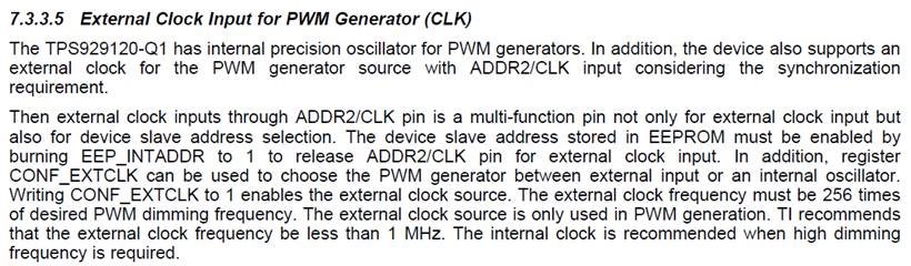

for diagnostic reasons customer wants to measure the forward voltage of the LEDs.
This is only possible during a HIGH-cycle.
According datasheet it is possible to feed in an external PWM signal from a microcontroller for example:
Means this that I can connect (for example) a 3kHz signals with duty cycle and this will be forwarded directly to the LEDs?
Many Thanks
Josef

  • Hello Frank, thanks for quick answer.
    But I think the idea is to feed in a PWM signal with duty cycle into the PWM pin and put this to the LED directly.
    So far I know the PWM pin is only to synchronize the internal PLL the the frequency which will feed in, true?
    Many Thanks
    Josef
  • That's right and i want to know why they choose external pwm input.
    as we have to measure the forward voltage of the LEDs externally with a microcontroller we need to know when there is a HIGH-level at the LED.
    So we need to synchronize the PWM of the LED driver / at the LED and the Analog Read-Out of the micro.
    For this the idea was to create a "main" PWM in the micro for the LEDs and give this as an input for the LED driver as a "common frequency".
    The Duty-Cycle for each LED should still be controlled by the LED driver as every LED needs to have a different intensity.
    Is this possible?
    What other options do we have to synchronize the PWM of the LEDs and the Microcontroller Analog input?
    Marco Tauber
  • 1) You can use internal ADC to measure the output voltage;
    2) if you use external pwm pin you can't individually control the outputs' duty cycle;
  • Regarding 1): it is not possible to use the ADC of the TPS929120, as this chip is not FUSI- / ASIL-capable. Therefore we must use another microcontroller
    Regarding 2): so what is the use of the PWM input Pin? Can you only control every LED together?
    Is there any other possibility to sync the PWM of the TPS929120 with another microcontroller?
    Marco Tauber
  • 1)  TPS929120-Q1 is FS-capable device, it can support ASIL-B system; I don't know what's the meaning of "not FUSI- / ASIL-capable";
    2) Function as PWM0 input channel for OUT0-5 in internal address mode, function as PWM1 input channel for OUT6-11 in internal address mode. So you can control max 2 group from the PWM input pin. You can use that to sync the PWM signal,
  • The driver is FS-capable, but it is not developed according ISO26262 and not suitable for ASIL C. This was not described correctly by me.
    The idea was to add an additional external LED-diagnosis to reach ASIL C, but as I see this is not as easy technically feasible as thought.
    Thanks & Best Regard,
    Marco Tauber
  • Only 2 external PWM can be used as we talk above.
