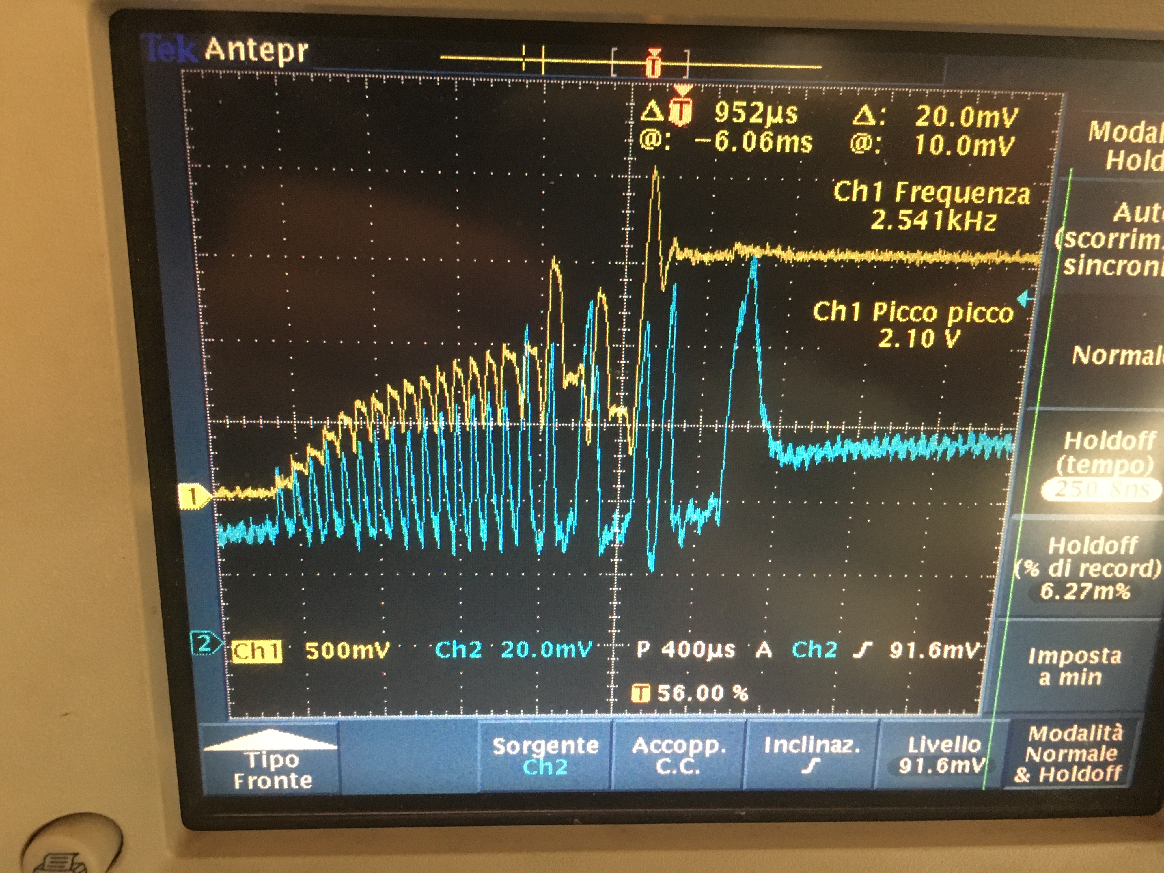

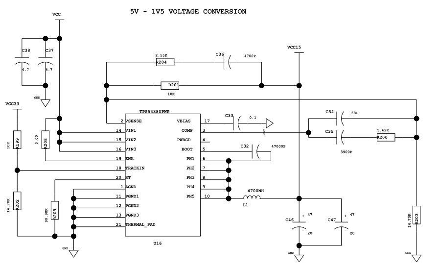

I've an old design with the TPS54380 where:
- Vin = 5V
- Vout = 1.5V
- Iout = 2.5 A (Core FPGAs)
In this situation, during the start up I've measured an oscillation behaviour of the VOut.
