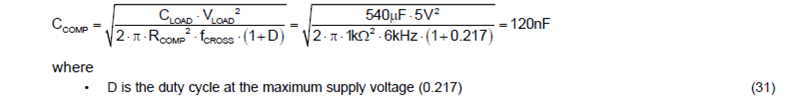

LM5155: APPS Note [SNVA866] : Wrong calculation result on Equation.
Part Number: LM5155
According to application note "How to design an isolated flyback using LM5155 [SNVA866]", you can see the following three Equations. However the calculation result seems wrong. Could you please check them?
Equation 29 : 8.68kHz -> 3.10kHz
Equation 30 : 1.15kohm -> 1.11kohm
Equation 31 : 120nF -> 542nF
Thanks and best regards,
