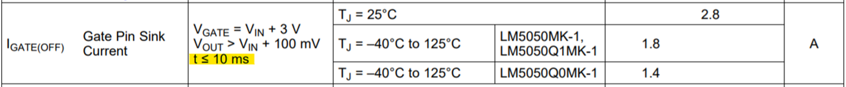

I have a design challenge where I would like to use the functionality of the LM5050 as an ideal-diode controller, but I would like to greatly decrease the turn-on time.  The design already has a +12V floating supply above the primary bus voltage.  My thought is to connect this +12V floating supply to the GATE pin via a 1k resistor.  When the LM5050 is OFF, it can sink up to 2A, and should be able to handle the 12mA coming from the floating supply bias.  When the LM5050 turns on, the MOSFET gate then becomes primarily driven by the 1k resistor, rather than the internal charge pump of the LM5050.  I have simulated this with three high-power MOSFETS in parallel (implying requiring lots of gate charge to fully turn on) and I decreased the turn-on time from 3mS to 100uS.  The simulation also shows that the nominal 20mV of servo-voltage across Vds is reduced, since at least in simulation the LM5050 does not appear to try and sink current into GATE in order to maintain the 20mV drop it normally servos to maintain.  Reverse protection appears to operate as expected.
Is there anything I am missing that would make a circuit like this unadvisable?

    One of your assumptions is that the LM5050 can sink 2.8 A of current. This is true but this is valid only for shorter durations of time '<10 ms' as mentioned in datasheet. below.  If the sink current capability of LM5050 is less than 12m A, this external circuit can damage the LM5050 and also turn ON the FET when  gate is disabled.
    In case you want fast turn ON of the gate, the best solution for you would be to use LM74810-Q1. It has a peak gate source current capability of 50 mA as shown in its datasheet EC table below.

    Your point is well received with regards to the continuous gate-sink current capability.  While my gut says 12mA would be ok, it is not defined in the datasheets and therefore cannot be assumed.
    In reading the datasheet on the LM74810, I noted the LM74700 shown in Fig 5, which for me is a little bit better of a fit.  I didn't realize these ideal diode controllers were available with charge pumps that use external caps, hence capable of higher gate drive currents.
