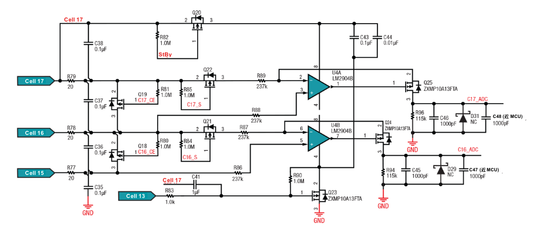

Hi
Could you explain the purpose of Q18,Q19, attached the schematic.
Star
  • Hi Star,
    Q18 and Q19 are cell balance transistors for cells 16 and 17 respectively.  The gates are connected by net name to a control from the MCU.  Balance current is limited by the 20 ohm input filter resistors.
