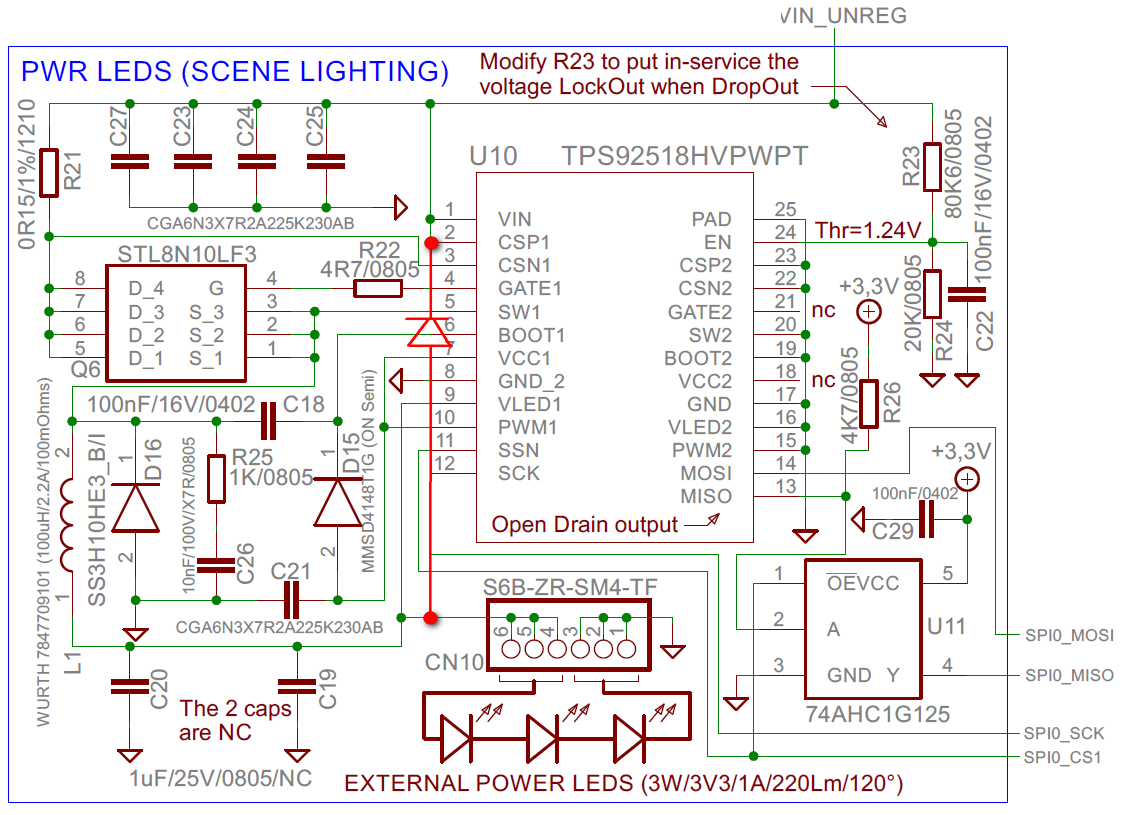

See the schematics attached.
SPI communications works well, no problem on this side and my first tests changing the LEDs brightness were also OK
But I burnt the assembly (now out of order...) with these parameters:
VIN_UNREG = 20V
VLED = 10V
3 serial LEDs, 3W each
Ipeak LED = 933mA (register LED1_PKTH_DAC = 140)
 LED1_TOFF_DAC unchanged default value (128)
1rst questions are for HW : why the TPS has burnt with theses parameters (after 10mn) . Except the external LEDS itself, nothing was hot (< 60°C) when this occured.
And what are the components out of order ? (TPS, MOSFET Q6 , diode D16 ...). I dont get any tools to check.
Concerning the LED1_TOFF_DAC: I did not modify its value according my parameters as specified in dataSheet page 15.
And how can I modify this register when my VIN_UNREG ranges from 10V...60V (it is a specification condition) and VLED ranges from 7V (min brightness) to 10V (max brightness).
I'm aware that when VIN_UNREG = 10V, I cannot get VLED = 10V. But I wish the maximum brightness possible with a 10V VIN_UNREG
Thanks by advance for your help
  • Hello Bernard,
    If toffDAC is set to 128 with 20V input and 10V output it should work fine.
    I calculate:
    6 us off time, as well as on-time with 20V input at 10V output, 83 KHz switching frequency.
    0.634A average output current.
    "1rst questions are for HW : why the TPS has burnt with theses parameters (after 10mn) . Except the external LEDS itself, nothing was hot (< 60°C) when this occured.
    And what are the components out of order ? (TPS, MOSFET Q6 , diode D16 ...). I dont get any tools to check."
    I don't know, it appears your schematic looks correct.  I also don't know what happened or was damaged, that is part of troubleshooting the circuit.  It could be several things.
    "Concerning the LED1_TOFF_DAC: I did not modify its value according my parameters as specified in dataSheet page 15.
    I'm aware that when VIN_UNREG = 10V, I cannot get VLED = 10V. But I wish the maximum brightness possible with a 10V VIN_UNREG"
    You do not need to change toffDAC, the idea of toffDAC is to set a peak to peak current ripple.  The off-time will change with changing Vled, this is normal.  This is not a fixed frequency part.  Vin can also change up to 60V, the on-time will drop but still be well above ton-min if toffDAC is 128.  The current ripple should stay constant with the variances.
    The TPS92518 should leave the MOSFET on until peak current trip is met so when Vin is 10V and Vled is 10V and the peak current threshold is not met the MOSFET will stay on until boot uvlo happens.  Then the switch node needs to cycle to refresh boot.  Note that if you are running it this way the MOSFET you have chosen has a high Vgs threshold so it can go linear if the boot voltage starts approaching boot uvlo.

    2-  In my schematics I wonder if the capacitors C19, C20 must be populated (in parallel with led) ?
    I found that in the schematics SDK but I dont know if they are usefull and what are their function ?
    3- In order to find the VINPUT_min keeping leds at their maxi current, I try to calculate the min_drop_voltage :
    min_drop_voltage = VINPUT - VLED - (0.15 * I led) - (VGSthr of STL8N10L3). Am I correct ?
    In this case I must choose à mosFET whith the lowest VGSthr ?

  • Hello Bernard,
    1&2)  Can or did the LED load get disconnected when the TPS92518 was operating?  Are the LEDs on a long wire harness?  See section 8.3.3.1, the TPS92518 can get damaged if ringing or voltage can exceed the voltage rating of the pin.  VLED is tied to the LED string, if that voltage can rise above Vin it can damage the part.  This can happen when shuntFET dimming.  I would also check to see if the LEDs are connected away from the output this voltage can also go high due to the inductance in the output wiring.  C19 and C20 would help preventing leakage energy current from causing voltage spikes.
    I'm not sure what "I found that in the schematics SDK but I dont know if they are usefull and what are their function ?" is referring to?
    3)  Close but not Vgsthr, it's (I led * RDSon, the voltage drop across the MOSFET when it is on)  Vgsthr is the plateau portion of the gate waveform where the MOSFET is turning on and the drain voltage is slewing.  You also have the resistance of the inductor as well as other losses that can effect the calculation.
    Also, because the TPS92518 regulates peak current your LED current will go up as Vin approaches Vled, especially without C19/C20.  This is because the ripple current is assumed to be a sawtooth waveform, V = L * (di/dt).  When the voltage difference between the input and output voltage gets smaller the resistor portion of the load starts to cause the current to ramp up as an 'RL' instead of just an 'L'.  The TPS92518 regulates peak current, the average is determined by the peak current minus 1/2 of the ripple current.  if the ripple current starts behaving like a charging 'RL' the average current will start to increase.  Your ripple current is fairly high so you will see this as the input voltage is lowered near dropout.
    4)  If the switching frequency is too high a couple of problems can happen.  One is switching losses causing excess heating, this includes TPS92518 gate drive switching loss.  If you are using 128 as toffDAC I don't see this as an issue.  The other problem can be if the minimum on-time threshold isn't met.  If the on-time needed is shorter than the minimum on-time the current will start to runaway.  This is more common with high switching frequency, high input voltage and low LED voltage.
    It would be beneficial to be able to look at waveforms with an oscilloscope to verify switching frequency and correct operation.
    As for your failure.  It was programmed and left to run for several minutes before it failed?  No changes during operation?
    TPS92518 damage can come from the MOSFET failing.

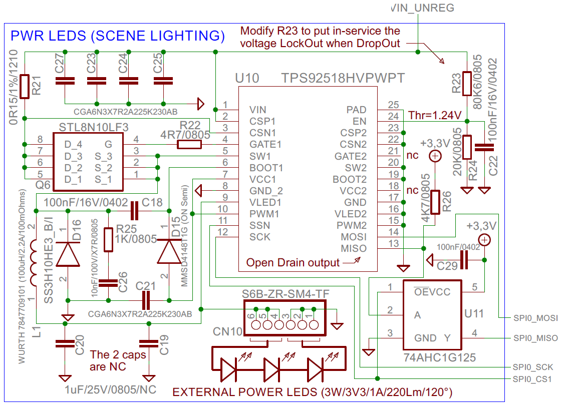

    3- Anti ringing diode : See the modified schematics...is this diode well connected (red wires)  ?

    3)  That is correct for the diode connection (it needs to be a low inductance connection).

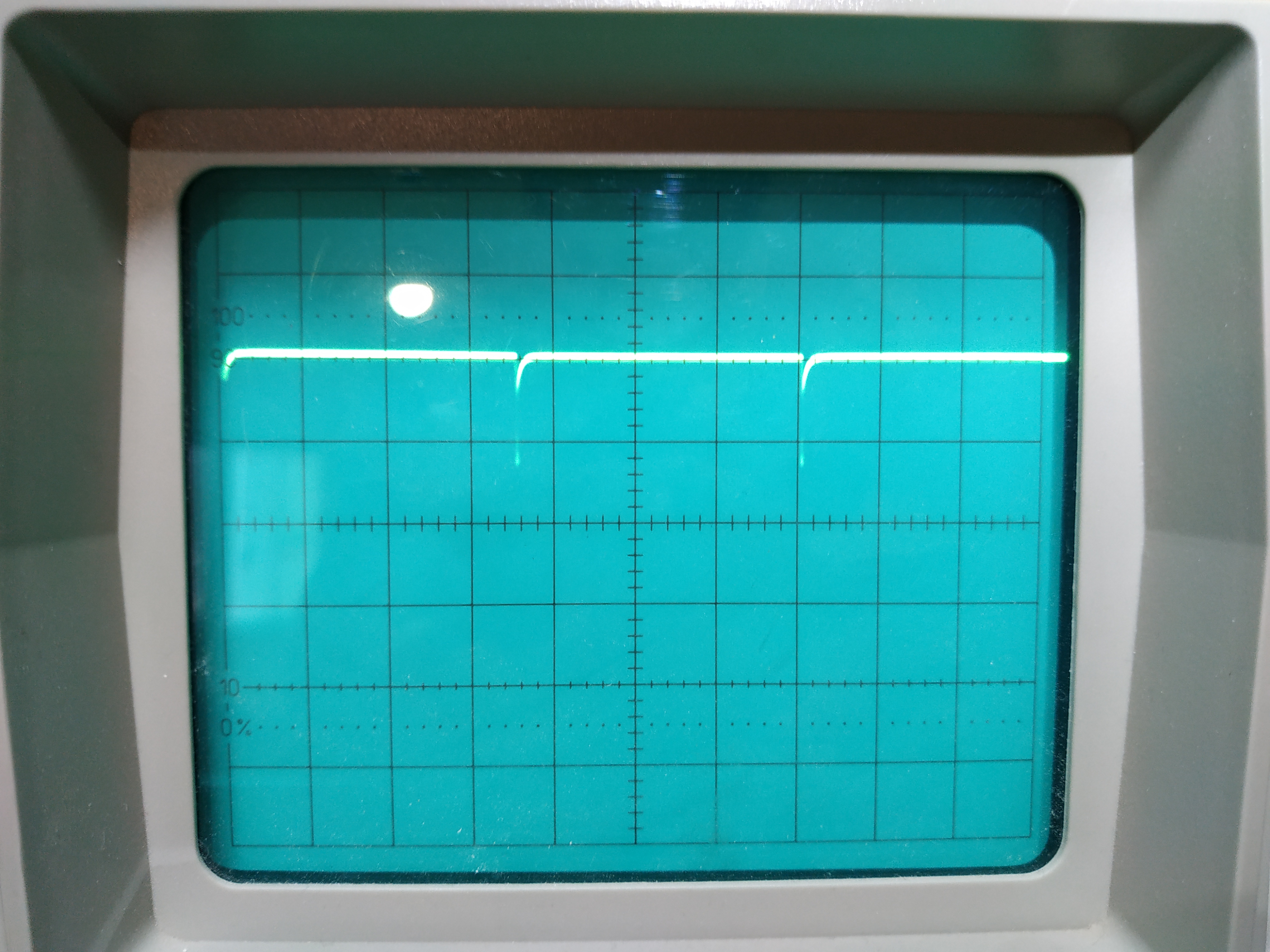

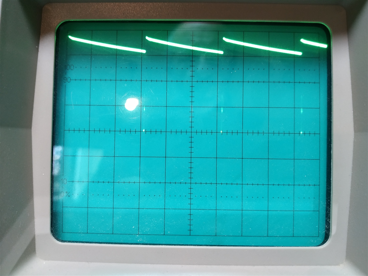

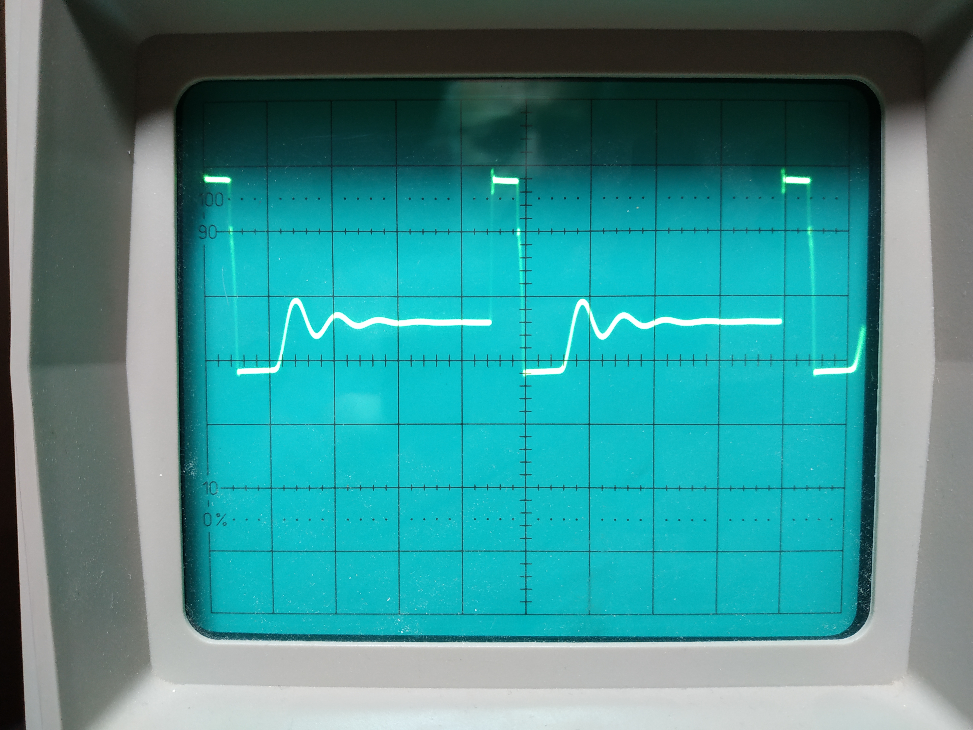

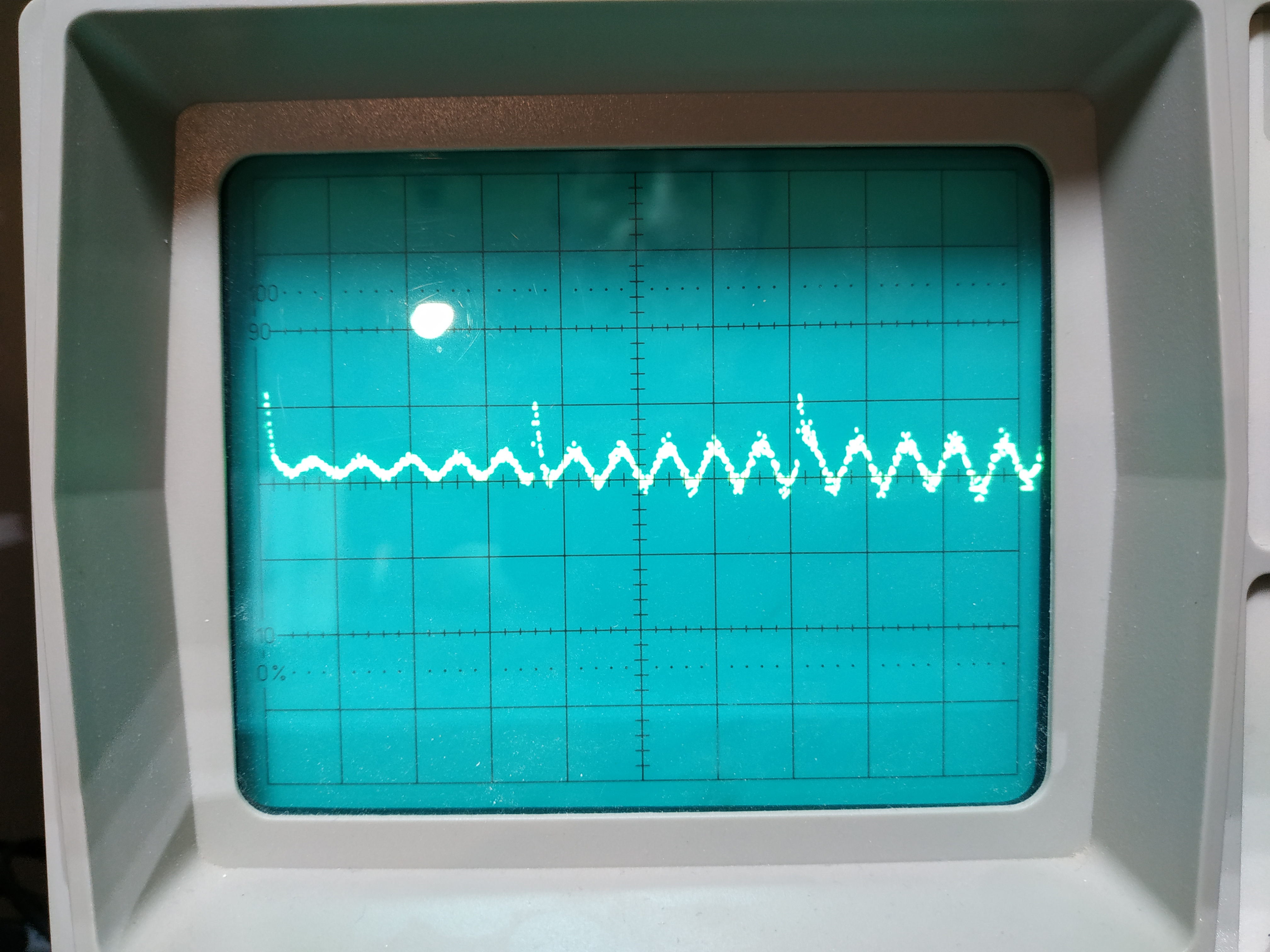

  • Hi Irwin,
    Here are the oscilloscope signal photos. Sorry for the quality but I dont get good tools here.
    VIN_UNREG = 10V
    photo1 : GRID of MOSFET 500us/div DC 5V/div
    photo2 : DRAIN of MOSFET 500us/div AC 200mV/div (dont take care of oscillation due to a bad ground of the oscillo probe)
    photo3 : LEDS anode 500us/div DC 5V/div
    Hope it helps !
  • Hello Bernard,
    You should be able to use this oscilloscope to figure out what is going on.  On photo 1, what is "GRID" of MOSFET?  I see the voltage up at about 18V drooping to 15V if it is 5V/div.  It almost looks like the TPS92518 is trying to do a boot refresh.  It doesn't appear to be switching.  What does the source of the MOSFET look like?  If you increase Vin it just draws more current and doesn't regulate?
    Also, if LED1_PKTH DAC is 14 it seems the deviation is more than this and it seems inverted?  Perhaps that waveform doesn't read correct.
  • Sorry Irwin,
    I wrote my answser too quickly.
    VINPUT = 10V
    GRID of MOSFET is GATE of MOSFET. and scale is 2V/div.(photo 1), so maxi is nearby 10V
    SOURCE of MOSFET is exactly the same signal than DRAIN of MOSFET (of course, because FET is always ON): photo 2.
    And I try to increase VINPUT upto 15V. After 14V the LEDS turn off  and system does not regulate.
    Bernard
  • Hello Bernard,
    How much current is going through the LEDs as you turn up the input voltage?
    With LED1_PKTH_DAC = 14 the current regulation should be fairly low.  It seems the MOSFET can turn on and off next is seeing if it is sense current and shutting off from peak threshold trip.
    The waveform of the gate will look like that if the peak current threshold cannot be reached.

    Have you tried using the EVM as a baseline to proved operation?  This part should work fine as long as TOFFDAC is not set too low.
  • Hi Irwin,
    Ok I use the LED1 BOOTUV ERROR bit and it works fine to detect if the leds have been connected or not.
    A couple of hours before I received the board with components changed (TPS, MOSFET and diode).
    The board is now working as it was initilally.
    But before (re)launching a long-term test at full led power, I want to ask you for an oscillation on the signal. Normal ?
    See photo of signal joined.
    On the test reprensented by the joined oscillo signal, the parameters set are:
    VIN_UNREG = 20V
    VLED = 10V
    Ipeak LED = 93mA (register LED1_PKTH_DAC = 14)
    oscilloscope settings are DC, 2us/div and 10V/div
    To be noted : when I set the maximum Ipeak current (register LED1_PKTH_DAC = 140) => oscillations vanished and we get a perfect square signal with a cyclic ratio = 0.5
  • Hello Bernard,
    What you are seeing is discontinuous mode.  The MOSFET turns on, high, turns off, goes to zero volts (actually a diode drop below zero), and then goes to the output voltage because the current in the inductor goes to zero, the ringing is normal.  This is normal operation.  When you get to higher LED_PKTH_DAC it eventually goes continuous and you don't see the zero current portion in your measurement since there is always current in the inductor) continuous mode), it will either be high or low.
    I also notice that you say 20V unregulated however the oscilloscope picture shows almost 30V.  Abs max for Vin is 67V.  If you exceed this you can damage the part.  I say this because I'm not sure what you are applying when you say 60V (unregulated 60V?).
    Watch this waveform when at your operating point when running for extended time to make sure there is nothing odd.  Also, is the IC pad being used for heatsinking and it is a good connection to your IC grounds, pin 8 and 17?  Is R21 located close to Pins 1, 2 and 3?  Also make sure it is not a wirewound resistor.  Just checking a few other things in your design.
  • Thanks for signal shape explanation.
    1- I confirmed that the VINPUT = 20V exactly (measured with a second multimeter).
    I confirmed the oscilloscopic signal of the TPS pin 4 (GATE1) is going upto 30V !
    I cannot explain that.
    Would that be a clue to find out what happened when the TPS burned out the first time ??
    2- I read the die temperature of TPS (register VTHERM) and it never grew more than 40°C
    R21 is close from TPS and the systeme is compact
    I will check for a wirewound shunt resistor
    Bernard
  • Hi Bernard,
    Sorry, that is the gate signal, it will be higher by VCC and a diode drop, this is fine.  That also explains the fast drop to 20V then the slower slew rate to ground since the current is low.  I generally look at the switch node so I was expecting that, so there is no problem.
    Just make sure R21 is NOT a wirewound resistor because it would add inductance in series with the current sense.  I just say this because I have seen someone use a wirewound resistor by mistake before, most likely it is not.  You can send the part number if you wish as well.

    One thing I should mention is boot UVLO error will also happen when Vin is close to Vout and peak current threshold cannot be met even though the LEDs are illuminated.
  • Hi Irwin,
    Bad news : the TPS92518HV has burnt again. The board is out-of-order...
    As you told me I ve added C19/C20 (1uf/100V) and protection diode between pins VLED and VIN (schottky 1A/100V)
    During the tests I read the die temperature of TPS each 10s.

    I forwarded this information to the systems engineer for TPS92518.  This doesn't make any sense.  49 Celsius is no where near the thermal limit for the part.
    Is the TPS92518 the only thing that fails during this test?
    Is D16 actually the part number on your schematic?  Just want to make sure the correct freewheel diode is on your board.

    Only one strange behaviour remains, that I could not explain.
    During my long-term test I read the die temperature each second (register VTHERM) and display the result in a terminal.
    And it works if I program LED1_PKTH_DAC = 80(decimal) or less
    But if I program, for example, LED1_PKTH_DAC = 200, the values returned for temperature are all the time wrong (so each second), a value like -293°C or +174°C or other bad result is returned
    As a strange fact more the LED1_PKTH_DAC is high less I get good result for temperatures and it is progressive:
    LED1_PKTH_DAC = 80 or less => all temperature read are OK
    LED1_PKTH_DAC = 100 or less => I get rarely a bad temperature reading
    LED1_PKTH_DAC = 150 or less => I get many bad temperature reading
    LED1_PKTH_DAC = 200 or more => all reading return a wrong temeprature
    Could it be the TPS which is not ready ?
    What 's your analyze on that ?
    NOTA : the word sent to read temperature is 0x2600 (read the VTHERM register)
    Bernard
  • Hi Bernard,
    I'm not sure what is going on here, seems like noise?  I can recommend getting the EVM and trying it to see how it works.
    I asked the systems engineer on this part and he's never seen this happen, here is his response:
    I’m not sure what he means by this command…. The temperature is in register 0x09
    NOTA : the word sent to read temperature is 0x2600 (read the VTHERM register)“
    He has to remember that with SPI you don’t get the temperature on that read, you get it after the next command…. I don’t know if that is messed up, but happens to work (even though maybe wrong) for that setting???   So when you issue a read you get the response from the last command, then when you do another command, you get the response for the first one you sent….   (I guess it doesn’t seem like this)"

    On my side I found the origin of the problem : a Crosstalk between power line (from VIN to LEDvia the MOSFET) and SPI pins.
    And when the led current is bigger, the perturbations provided to SPI lines are bigger too!
    I plugged a logic analyzer and saw that SSN pin get unwanted narrow spikes in some case (spikes of 10ns approx.).
    The TPS is driven by a JETSON Nano board and between CPU and SPI lines there is a TXB0108, which is not good for immunity.
    I soldered a simple 100K resistor between GND and SSN pin and now things are working much more better  (I cannot solder a lower resistor because of the TXB0108 max impedance driven) .
    So in next version of PCB I will insert a good buffer between SPI lines and TPS92518 with low pullDown resistor (2K2) to increase immunity.
    Bernard
