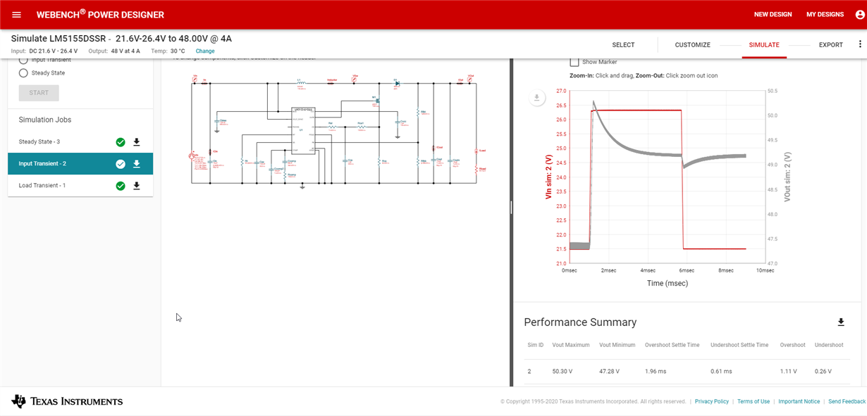

Simulation results sometimes don't appear as below.
Could you tell me how to stop this symptom?

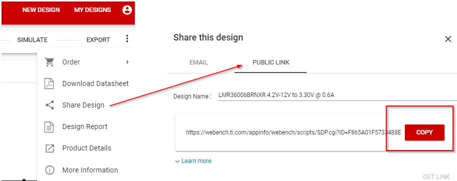

Hi Praveen-san,
Thank you for your help.
The URL is the following;
https://webench.ti.com/appinfo/webench/scripts/SDP.cgi?ID=25CAD1C0B09D229D

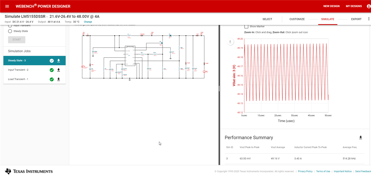

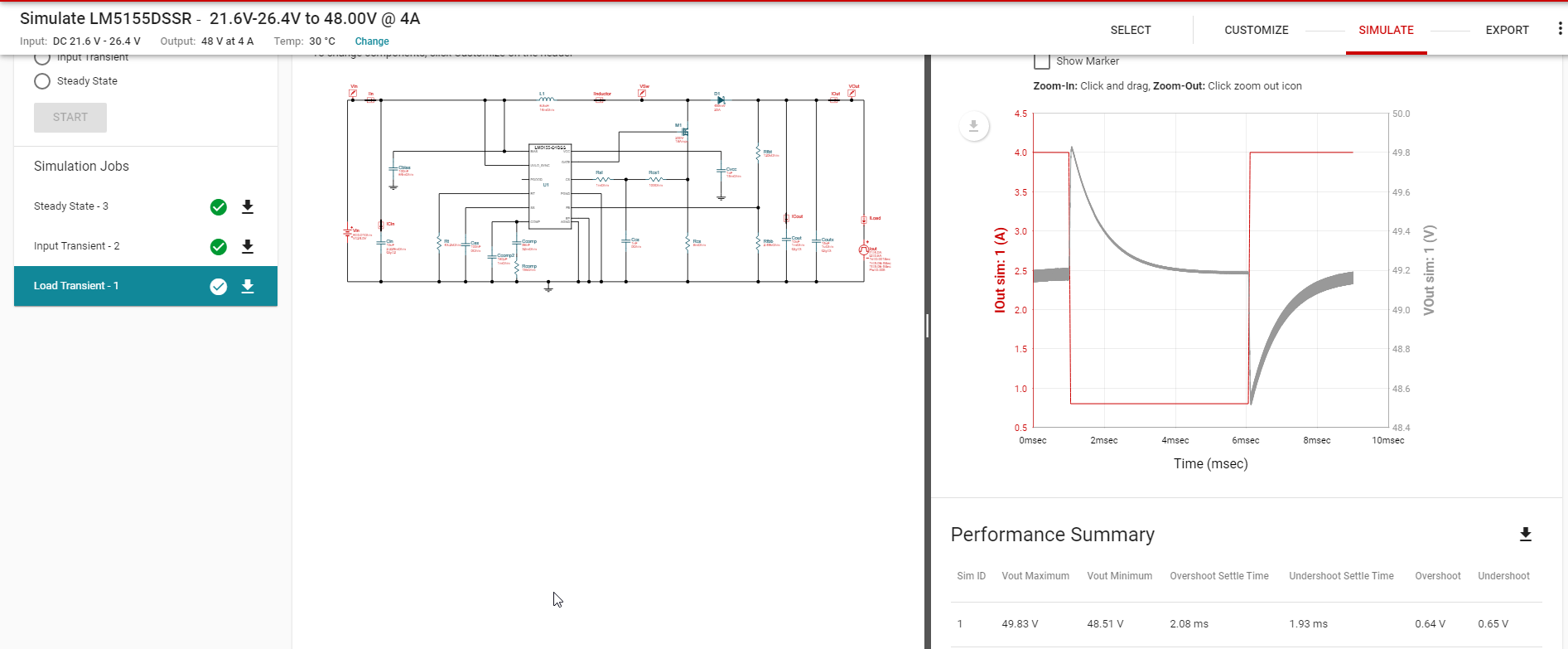

Hi Kuramochi-san,
We hav simulated the WEBENCH shared design.The simulation time was exceeding more than 15 mins due to which the simulation was getting failed.
Please note that the performance summary doesn't show up in the below case.
1. WEBENCH simulation fails due to timeout
2. WEBENCH doesn't load the waveforms within a specified time.
3. WEBENCH could not find the current /voltage within the simulation window.
We have changed the simulation analysis parameter to reduce the simulation time and all the test benches are getting simulated within 15minutes. Also, the performance summary is being shown for all the simulations. The changes will reflect on ti.com by the end of December

Load transient:
Input transient:
Steady State:
