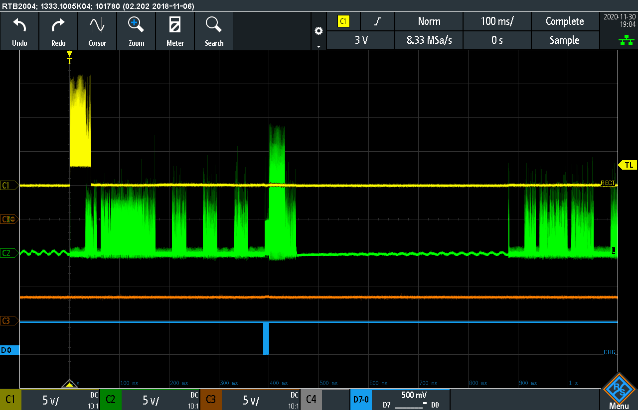

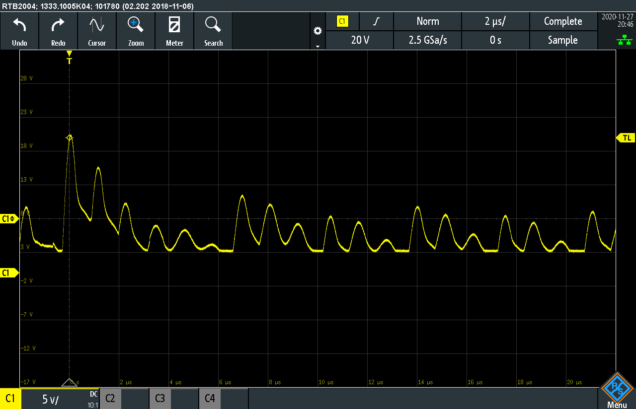

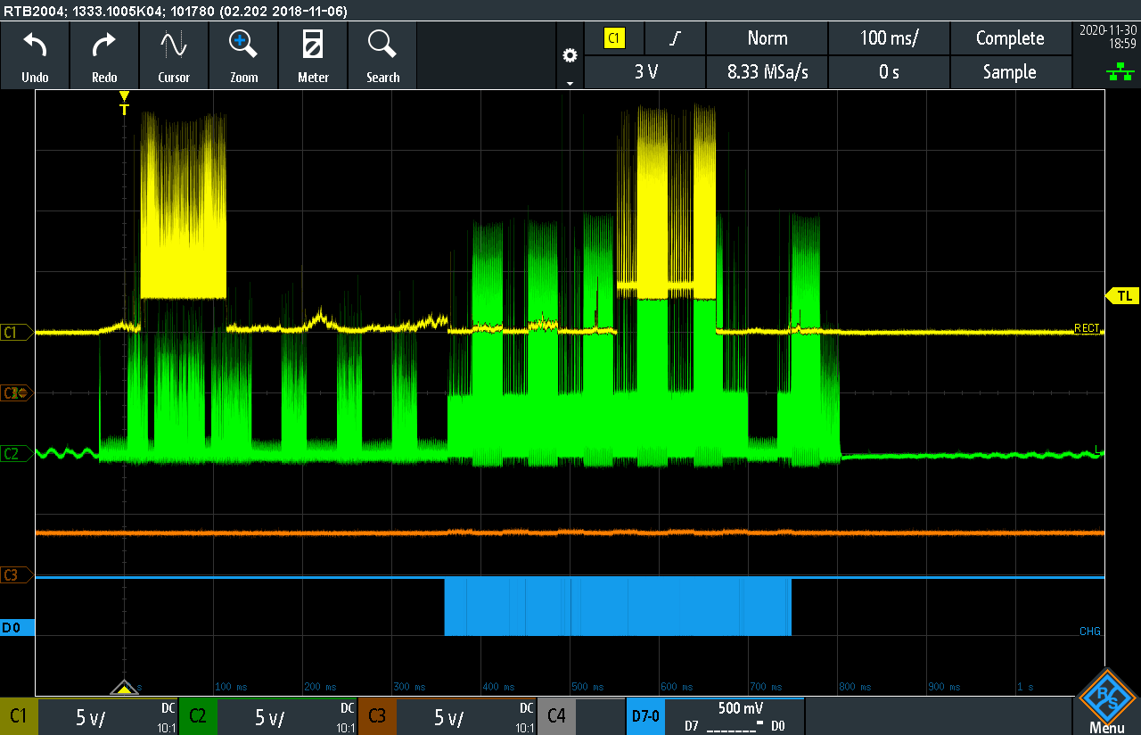

I read the FAQs and: my problem definitely isn't from overheating: I'm using either a 100mA or 500mA max charge current and the device does not get hot. I also looked at the voltage on the RECT pin. It does seem to get higher than the 7V threshold (sometimes much higher). I've enclosed some captures of the RECT pin, in various timescales. I'm not sure what the RECT pin is supposed to look like.

  • Hmm. Not sure what OUT is — I seem to have BAT and CHG in the bq51050B.
    My traces do not look anything like yours :-/
    C1 is RECT, C2 is AC2, C3 is BAT, and the blue D0 line is CHG.
  • Hello
    The RECT should be a DC signal, could have a small amount of AC ripple.  It is the full wave rectified AC1/AC2 signal that is filtered by the capacitors on RECT.
    Could you have a ground problem with the test set up or board?

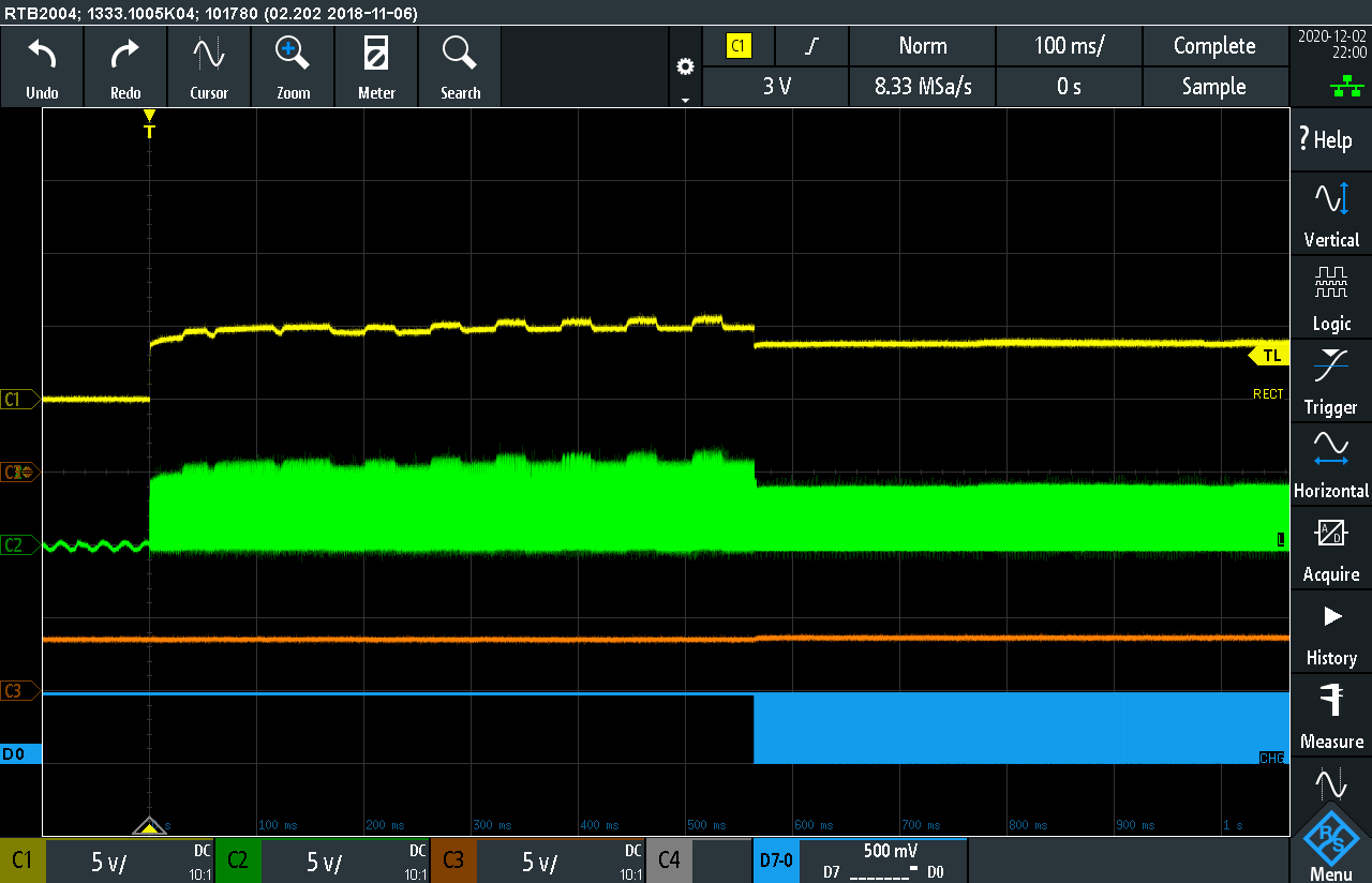

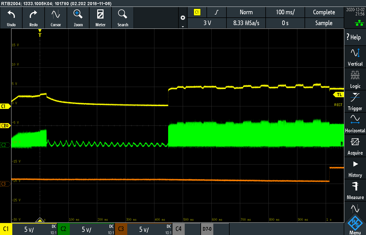

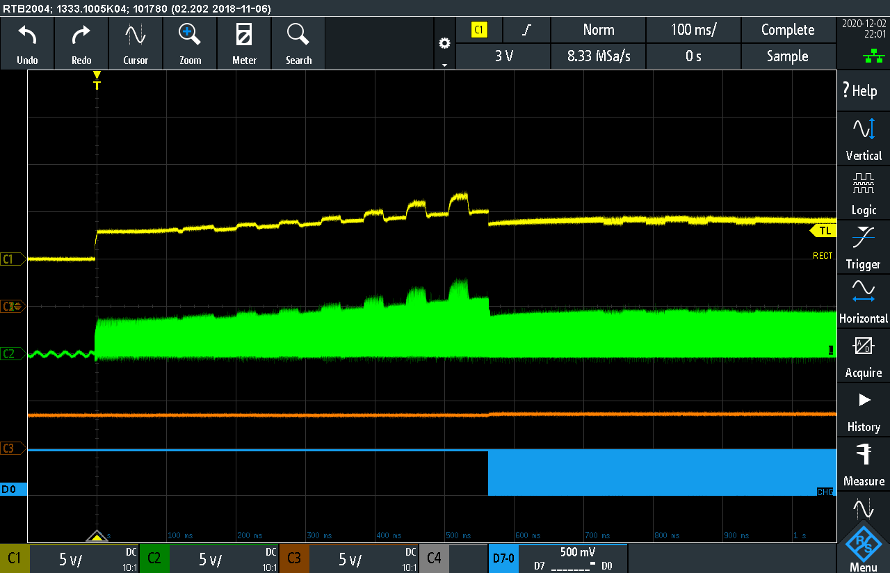

  • As I read "filtered by the capacitors on RECT", I thought to myself "what capacitors on RECT?". Well, as it turns out, the designer (that would be me) forgot to include the RECT capacitors in the design. A silly error, which was not caught by the design review team (er, that would be me) before prototypes were built. I have no idea how that happened.
    So. I rigged a horrible contraption by quickly soldering a THT 10uF cap on top of two 0402 components, the only place where RECT is accessible on the board, and indeed one could say the situation has been vastly improved :-)
    Please let me know how these traces look like. I'll keep thinking about how to rework those prototype boards, but it's likely it won't be possible, so I will need another spin. I'd like to know what else to look at before I do that.
    The first two screenshots are without the battery connected, so the C3 orange trace shows the voltage on the BAT pin with no battery. The last two also show the CHG output (D0, blue) — should it be oscillating like that?
  • Hello
    looks much better
