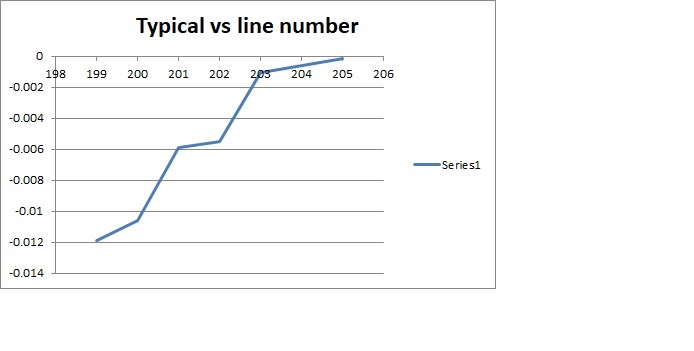

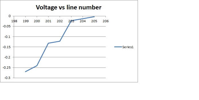

  • Yihe, I looked at the actual numbers in the file, and they are monotonic, but only barely.  It looks like the ibis program is just going down the columns and looking at variation in slope.  The problem with that is that:
    The voltage steps driving everything are not even.  There's a big step in voltage and then a small one.  So there's a big step in current, and then a small one.
    So I'd say everything is fine.  Here are graphs of voltage and typical to show what I mean:
    You can see that the uneven voltage steps lead to uneven steps on the current measurements.  And you can see that when the slope decreases significantly, that seems to trigger the note from ibis.  It looks like if you graphed current vs voltage, you would get a nice smooth line.
    I probably didn't need to dig in that much, but I couldn't resist.

  • Yihe, if you looked at them right when I posted they didn't show up.  However, I've edited it since then, and I can see them up there.  If you can't see them now, let me know and I'll try to fix it.
  • Hi Ian
    Thank you. I can see the figures now , but How do you get the Y-axis data for the two figures? They do not look from file directly.
    Yihe
  • I put the file into excel, and the row numbers corresponded to the line numbers.  That's actually the X axis.
    The Y axis definitely corresponds to the data from the file:
