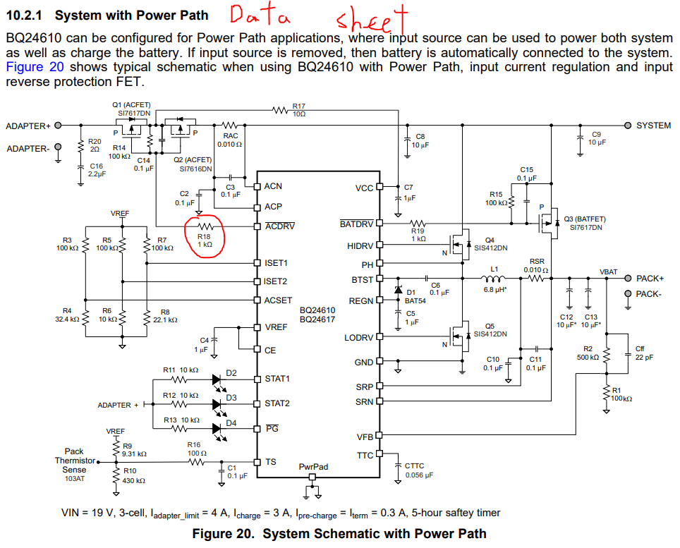

Hi I'm trying to use BQ24610 to charging battery and I found different between reference schematic in datasheet and BQ24610 EVM's schematic.
this is EVM board's  shcematic and there is two 1K ohms (R21, R24) but reference schematic in datasheet(second picture) has only one.
I have no idea why EVM Board has two 1k ohms
please some body help me
