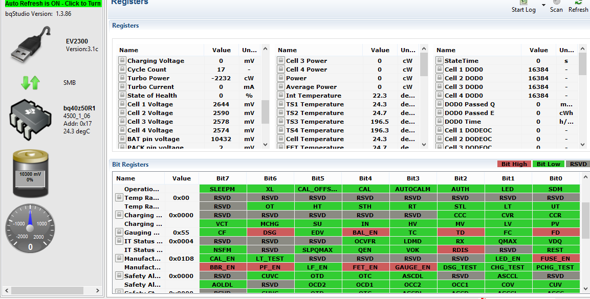

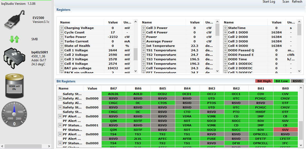

We are using BQ40Z50-r1 in our battery pack Design.
The Sleep mode current is 300uA.
To put the battery in Sleep mode we have made the System present to be left  floating and the current is reduced to 150uA.
But in the Datasheet(BQ40Z50-r1) it is suggested that the sleep mode current is about 75uA.
Kindly suggest a way to reduce the sleep mode current further.
(In software we have set the following registers to 1 and they are NR,IN Sys_sleep mode bit,)
