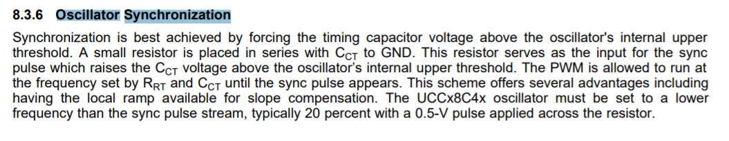

    The last thing I want to make sure is that if maintaining the 5:1 ratio of sync frequency to programmed RT/CT frequency is recommended, then why a 400kHz square wave is input to the RT/CT pin, UCC28C45 will generate a PWM of the same frequency, 400kHz?  I don't understand the relationship of the ratio and the output PWM frequency.

    The 5:1 ratio is specifically recommended for a sync pulse with an amplitude of 0.5V applied between the timing cap and a small resistor to ground as shown in the datasheet diagram. This configuration is summing the pulse with the existing RT/CT ramp to trigger the timing cap to discharge. The more relevant relationship is between the ratio and the amplitude of the sync pulse. The peak threshold for the RT/CT pin is on average ~2.52V, this is the value that has to be passed by the RT/CT pin voltage in order to trigger discharge. A higher frequency ratio is needed for a smaller amplitude and vice versa. In theory you could have a 1:1 ratio of programmed frequency to sync frequency as long as your sync pulse amplitude was > 2V.

    Besides, could you please kindly further explain the two sayings shown as below?
    1. Is the 20 percent the same as the 5:1 ratio we talked about? 2.The output frequencies of the UCC28C45 is half the oscillator frequency. Does it mean if the 400kHz square wave is input to the RT/CT pin, UCC28C45 will generate a PWM of 200kHz?

  • Hi Wendy!
    1. Yes, the 20% here is referring to the 5:1 ratio we discussed.
