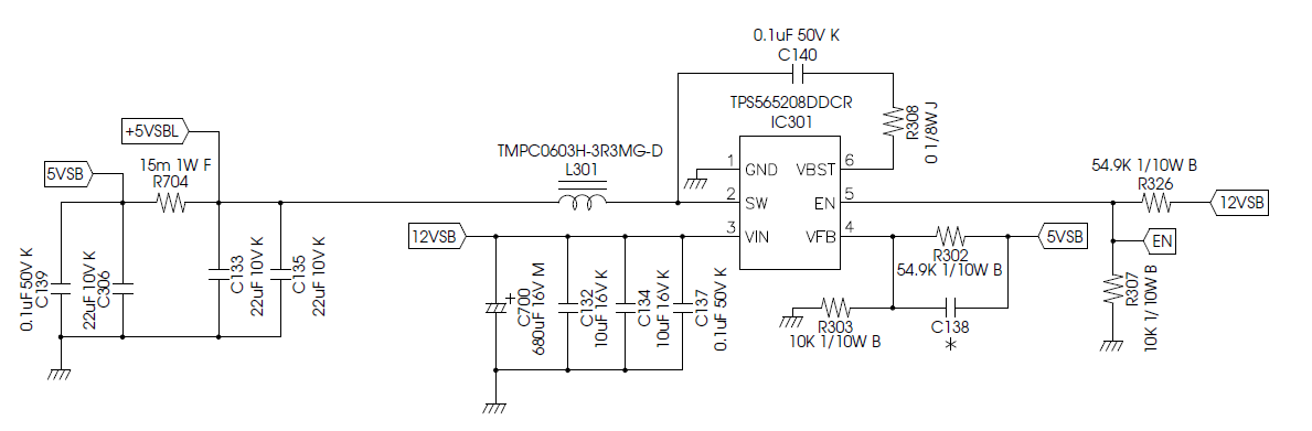

pls refer following for TPS565208 application schematic

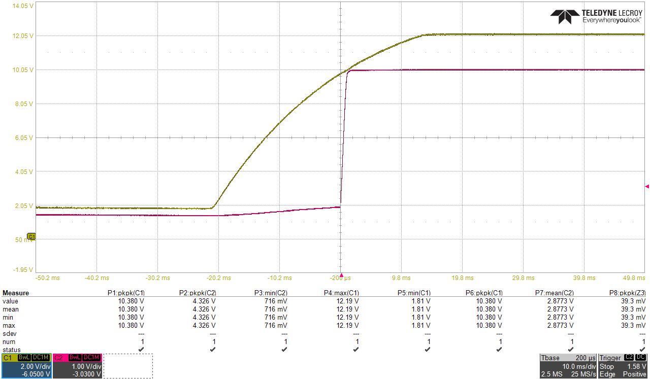

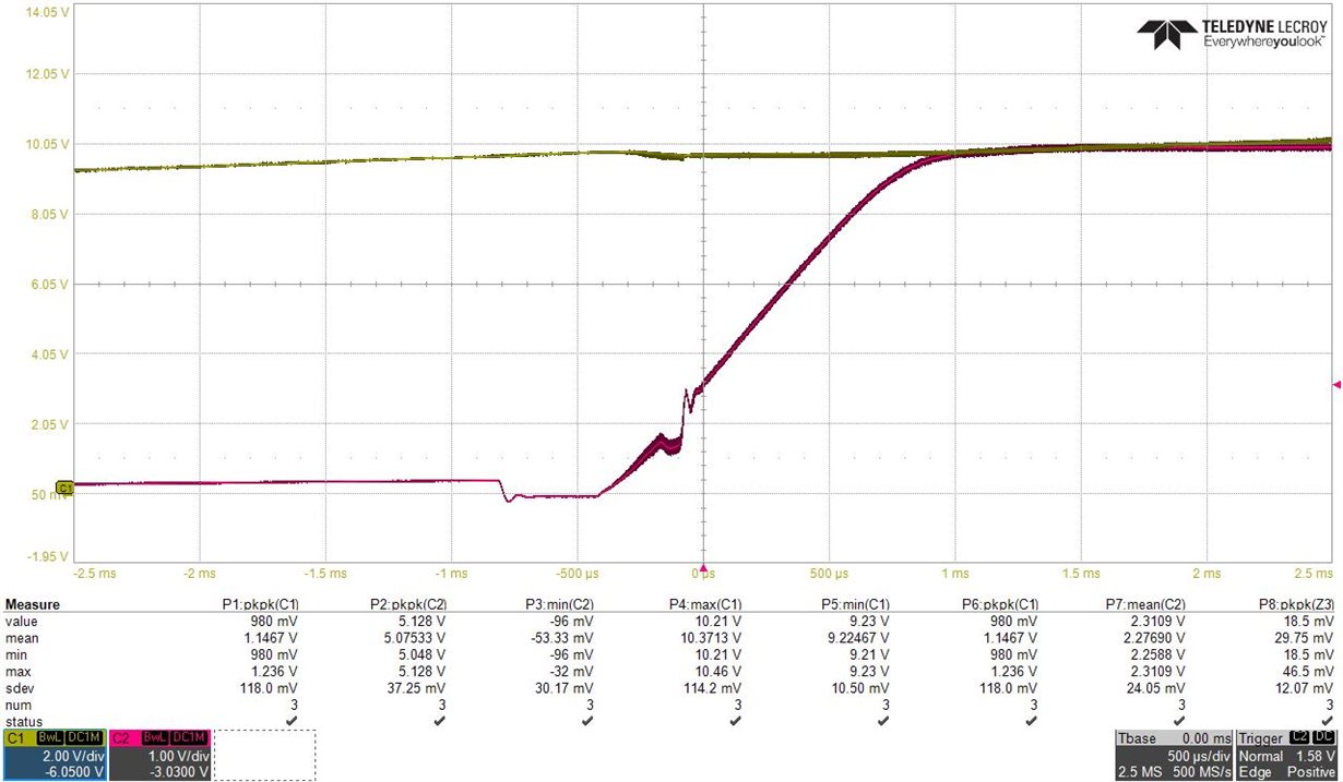

we suffered the start up issue both in max load no load conditions
in max load VOUT will have negative voltage
in no load VOUT will delay around 10mS after VIN established

max load start up
CH1 VIN
CH2 VOUT
NO load start up
CH1 VIN
CH2 VOUT
  • Hi Red,
    For max load, I check 1V output condition, the waveform is normal as below. Could you help check whethter 1V is normal from you side?
    For light load, Vout begin to ramp up until EN is high. As you use 54.9k/10k resistors, there is some delay between VIN and Vout ramp up.
