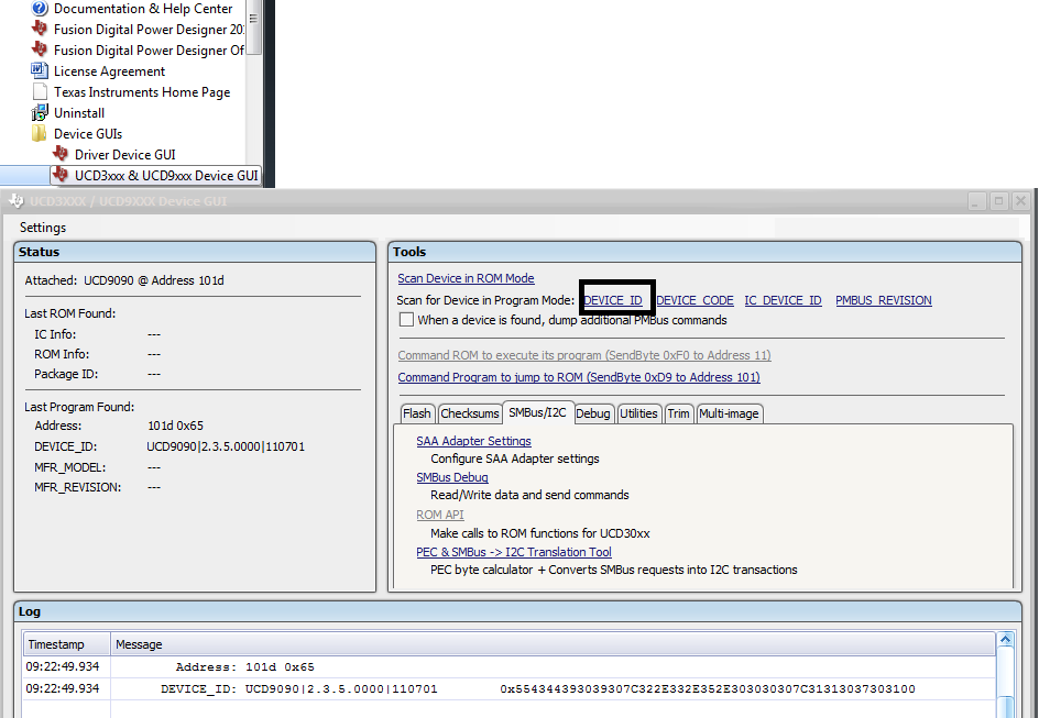

    Could you tell where you receive the x0 file? Why do you want to update the x0 file? Customer shall not update the x0 file unless they are asked to do so.
    is 78 the correct address of UCD90120A? It seems that the address is not right.

  • Hello
    No, customer shall not flash x0 file.
    Please follow below to make sure that the correct address:
    Launch UCD90xxx device GUI and click the DEVICE_ID. the correct address shall be reported at left.
    Yihe
