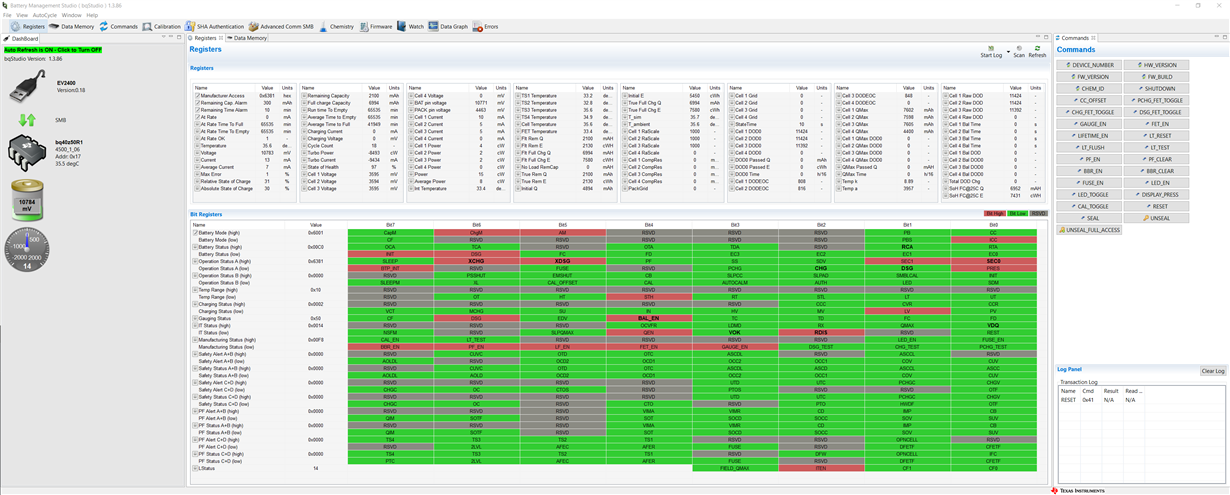

We have been using the BQ40Z50-R1 for several years in a number of consumer electronics for our BMS solution.  It has performed as expected fairly reliably in an expected fashion until recently. Our design and test teams have begun experiencing a new behavior that we can't explain.  Our applications are various types of energy storage systems with integrated charge controllers and power conversion for multiple outputs.  A central MCU communicates with the BMS IC and several other peripherals.  In the last 2 weeks, we have started seeing the following behavior from units that previously performed as expected:
  1. A load is connected to the ESS that creates a 1C - 1.5C discharge from our pack
  2. The unit discharges normally for several minutes
  3. The display on the product shows the state of charge begin to decrement at a rate of approximately 1 percent per second until 0 is reached.
  4. After a long period, typically 1-2 hours, the state of charge returns to the expected value

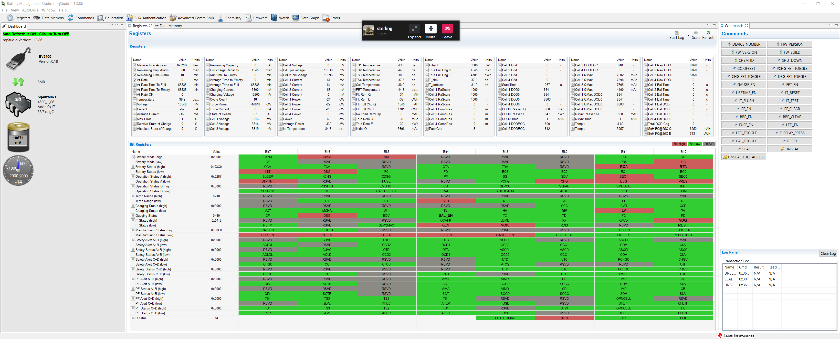

We have several captures from Battery Management Studio showing the state of the battery after 0% SoC is reached:
As well as after recovery:
One thing we've noted is that the charging and discharging have been disabled in OperationStatus (XCHG and XDSG).  We're continuing to look into this but are hoping one of the experts here can speed us along the way to understanding and resolving this.  Also included are the gg files from immediately after the event and after the pack has resumed normal operation.
Please let me know what other information might be helpful in diagnosing. Thanks in advance!

  • Hello Sterling,
    Are you able to log the occurrence with bqStudio so we can see what the registers are indicating? Is there anything specific that causes it to happen, is the only thing done to recover is let it rest for a couple hours?
    If you can't capture the event itself, logging the time after when the gauge recovers would also e helpful.
    The .gg files are the same, I couldn't find any differences.

  • Sorry, we're new to posting here.  Please see our other posts with the requested log files and additional information.
  • Hi Sterling,
    Can you briefly explain each log as their are 4 attached.
  • Nick,
    From my comment above, I described the four logs obtained:
    Wyatt,
    I am working with Sterling on this issue. I was able to capture 4 logging sessions in bqStudio where the 1000 Wh 3S battery started off fully charged and was drained with a sustained load of 1500 W. I started recording the first log shortly before the first SOC rapid drop to 0% occurred, just after the RSOC reached 75%. I then removed the load and waited for a brief moment to show that the issue tends to stick around for a while. I then unsealed the BMS and sent the RESET command because we have observed it will remain in this state for 2+ hours otherwise. After the BMS resets you can see from the logs that the RSOC jumps back up again, but only to 69%.
    After this initial test I continued repeating the cycle described above as I tried to drain the battery completely with the same 1500 W load. On the second run the battery drained from the reported 69% down to 49% before suddenly dropping to zero. I again sent the reset command and after resetting the BMS reported 29%. Before draining again this time I sent the reset command once more and after resetting the BMS reported SOC jumped higher again to 43% - all with no charging occurring.
    I continued in the same manner for the two remaining logs - draining from 43% to 31% before the SOC fell immediately to 0% performing two resets to get the SOC back up to 27% and then draining from 27% down to 14% before the issue occurred a final time. After two final BMS reset instructions the SOC went back to 14%.
    It seems the issue may be related to the Impedance Tracking algorithm and the Ra table values that are currently in data memory. Admittedly we are not very familiar with impedance values that are expected versus abnormal in the Ra table however.
  • Hi Nick,
    Please see the description of the logs provided by Zachary above as he was the engineer that collected this information.  We're working together towards solving this behavior.
    Sterling
  • Hello Sterling,
    Can you share the original .gg file you used to program the gauges? I'd like to compare the Ra tabled. Since the Qmax and Ra are mostly what the gauge tracks for the batteries it is probably relating to these parameters.
    The behavior when you send the reset command is expected, if you send the reset command right after a discharge the gauge will try to correlate the voltage (which is still recovering from discharge - lower than it would be at rest) So the gauge thinks there's less capacity than there is, when you send the reset again it then correlates the voltage again which has now recovered more so the gauge thinks there's more capacity.
    Sincerely,
    Wyatt Keller
  • Hi Wyatt
    Here is the original .gg 'golden file' from our pack supplier. Please let us know what you uncover!
    Sterling
    P010-MP1-0408.gg.csv
  • Hello Sterling,
    It looks like the Ra tables aren't too far off, it looks like they're about double from the original, but with battery aging that's not that ab-normal.
    Is this only occurring with the older systems that have been running for some time?
    Can you upload the original .gg file to the gauge experiencing the issue to see if it continues?
    Sincerely,
    Wyatt Keller
  • Hi Wyatt,
    The other engineer in this thread, Zach, has attempted something like this.  He can speak to this in more detail, but yesterday he did take a gauge with this issue and overwrote the Ra and QMax values with the original values and the pack behaved normally again under the same test condition that created the problem behavior before.  He went even further and wrote these parameters back from a previous capture where the issue occurred - this caused the pack to exhibit the same bad behavior again.
    At this point it seems clear that something about the way the pack/gauge has been used is creating bad values in the Ra table which leads to the bad SoC behavior. Specifically, we wonder if this is caused by a test scenario under which we charge the pack at up to 0.6C with a constant load on the pack of 0.2C.  Also, we have restricted the state of charge in this case to stop charge at 95% SoC and restart charge at 90%.  Would you expect this situation to result in this behavior?
    Sterling
  • Wyatt,
    I uploaded the original .gg file to the gauge and the problem did in fact go away after doing another discharge run. I then experimented putting the "corrupted" values back and the problem recurred. Because the Impedance Tracking relies primarily on the Ra table and Cell QMax values, I then modified our product's firmware to only revert the Ra table and QMax values back to the pack manufacturer configuration settings from the .gg file as part of a factory reset, and that also made the issue stop recurring. As a result, we are planning on having a discreet feature in this product that will be able to revert the Ra table values and QMax values only as part of a factory reset procedure.
    While this proves the issue arises from the impedance data, we still are not sure exactly what behavior toward the battery pack causes this issue to develop in the first place. As Sterling mentioned, some of our end users will utilize their power system mainly as a sort of UPS power supply where a small but load is connected and a relatively larger charging source is connected to the charge circuit which will charge the pack up to 95% RSOC and then allow it to drain back to 90% before it charges the pack up to 95% again. This process can repeat dozens of times over several days after which we theorize the impedance values may again become corrupted. We are in the process of validating this theory now. Is it possible that cycling the battery in a relatively small window of discharge/recharge cycles can cause problems with the Impedance Tracking algorithm?
    -Zach
  • Hello Zach,
    We have seen large pulsed loads change the Ra table so it behaves similar to this. You can try reducing the max Ra delta and the Resistance Parameter Filter, this may make the Ra table updates more stable with high or pulsed loads.
    Sincerely,
    Wyatt Keller
