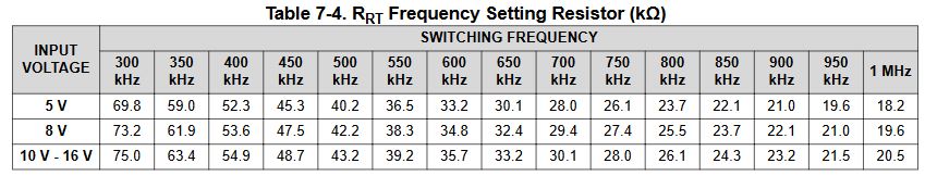

May we know if we have frequency tolerance for single phase operation? Customer is using our TPS543C20A for 500kHz fsw setting, test result for switching frequency is 553kHz. Thanks a lot!

Hi Ann Lien,
Between multiple boards using the same RT value, you should see that they are matching within +/-10% or so.
Is the customer using 39.2kΩ for RT resistor? They may get a nominal value closer to 500kHz by using ~43.2kΩ. Please see table below from a similar device:
