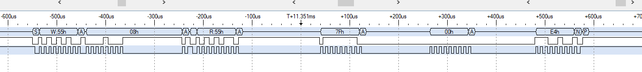

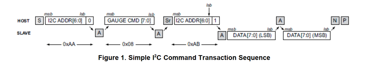

According to application note SLUA790  it indicates that when reading command data 0X08 it responds with 2bytes data
but in actual test for this command and any similar commands it responds with 3 bytes data .
can you explain this result, pleas?

  • I'm trying to read battery voltage it is 14.2v Li-Ion pack battery .
    No it isn't correct ; expected 443mv  and getting : 377 mv after Hardware voltage divider
    yes i found this every time and with other commands
    i use my own hardware not evaluation board and this capture from logic analyzer display.
    i note that i can't access data flash memory i tried to write required address in ManufacturerAccessControl()
     then read it .the reading value is 0x0000.
    why i receive 3 bytes ? and what is the correct number of bytes should i receive?

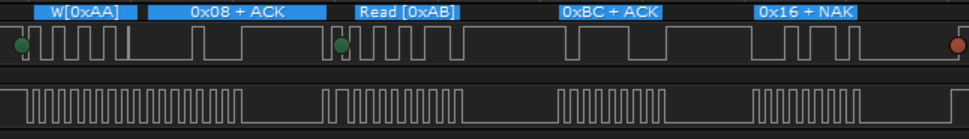

  • Hello Gehad,
    Are you able to check with the TI toolchain using EVM, EV2400, and bqStudio to see if you are getting the same issues?
    You should only receive 2 bytes back, Sometimes a 3rd byte will be present but the first 2 are the only ones with relevant information. I attached an example from another similar gauge. I suspect it may be a hardware issue or host MCU firmware issue.
