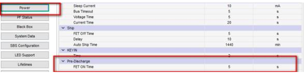

We are using BQ78350-R2 FW.

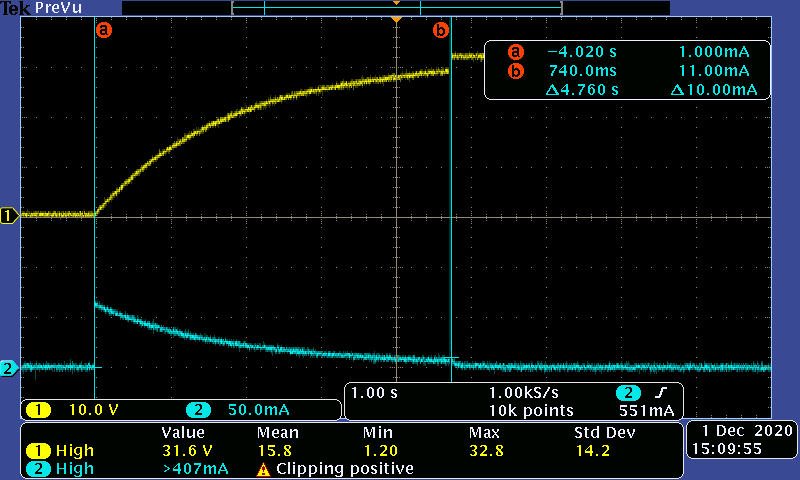

And we measure the ON time has some tolerance.
Please refer the figure as below, that we set 5 seconds but the result is about 4.8 seconds.
Please let us know the tolerance of FET ON Time.
