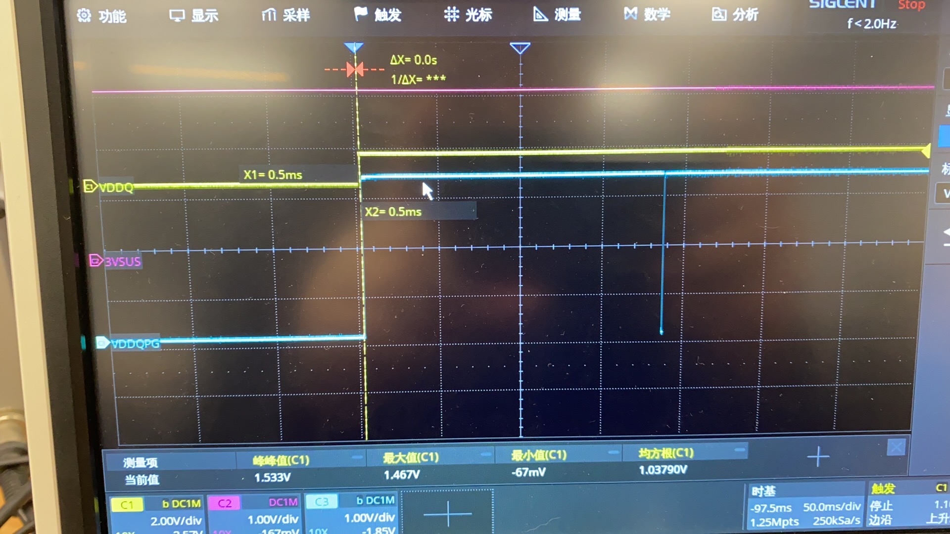

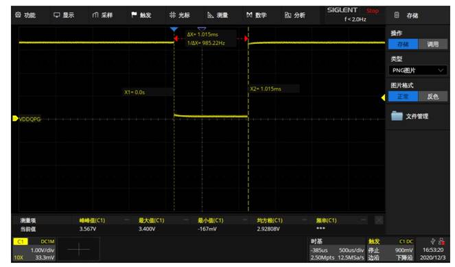

My customer is using TPS51216 and have a sag issue on PGOOD (either with 200k, 100k, or 10k pull-up resistor) when VDDQ & VTT are normal, do you have some ideas here that how it can happen?
Thanks a lot.
Yang

Hi Yang,
Can you ask customer to remove all other connections on PGOOD, and just keep the connection to TPS51216 and pull up voltage to see if this issue still exist?
Weidong

Hi Yang,
From the schematic we can not see anything that can cause PGOOD sag. Can you help to provide more information below?
1. What's the failure rate? Is customer seeing this issue on every board?
2. In the waveform above, did customer disconnect all other connections on PGOOD other than pull up and the connection to TPS51216?
3. Can you ask customer to provide Zoomed in VTTSNS, VDDQSNS and VTTREF waveform during PGOOD sag? It will be more helpful to have proper vertical scale so we can see if there is glitch on these waveforms.
4. After the above debug, we can ask customer do A-B-A swap to see if the issue still exist.
Weidong
